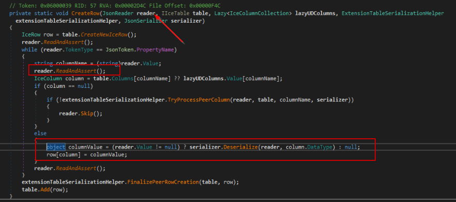

After much reverse engineering and debugging it turns out it isn’t an Epicor issue its a Newtonsoft Issue specifically if you use a JTokenReader (Epicor does) to loop through each item in the JSON DataSet and assign the like value on the other side
Here’s what Epicor Does

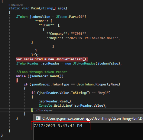

I wrote a simplified version of the same outside of Epicor using just C# Visual Studio
JToken jtokenValue = JToken.Parse(@"{
                      ""ds"": {
                        ""UD40"": [
                            ""Company"": ""C001"",
                            ""Key1"": ""2023-07-17T15:43:42.461Z"",
            var serialized = new JsonSerializer();
            JTokenReader jsonReader = new JTokenReader(jtokenValue);
            //Loop through token reader
            while (jsonReader.Read())
                if (jsonReader.TokenType == JsonToken.PropertyName)
                    if (jsonReader.Value.ToString() == "Key1")
                        jsonReader.Read();
                        Console.WriteLine(jsonReader.Value);
Guess what? The value of jsonReader.Value is a Fully formed (datetime) because of some "assumption’ that Newtonsoft is doing so when you assign jsonReader.value to the EpicorRow[“Key1”] C# does a ToString() on it to store as a string and thus you get a "different’ format of the value.

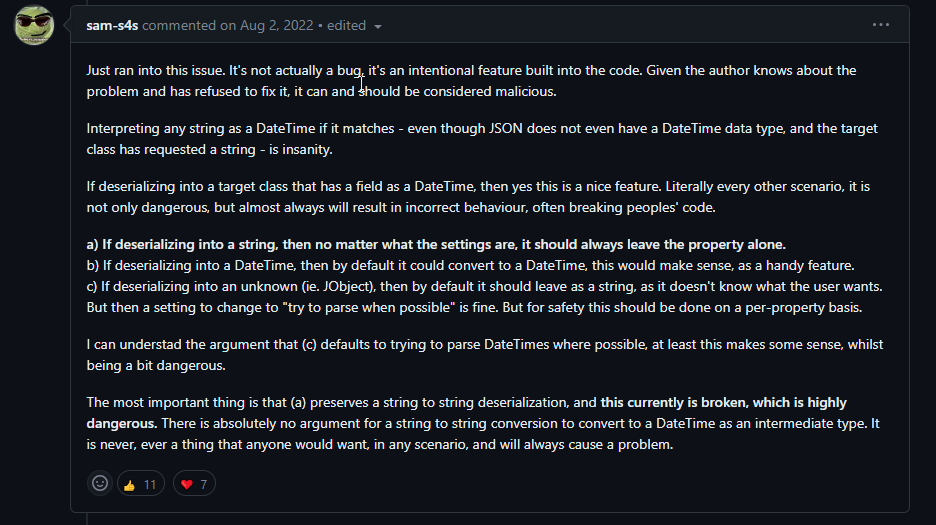

Lookie here someone else b*tched about it
They closed the issue as “a feature not a bug”… say… do they work for support too? :joy:
The argument is that there is no standard "date’ format for JSON so THEY Newtonsoft decided that ISO is “THE” standard and you can override it with some flags but basically if it matches the format you are SOL.:poop:

However I very much like this guy’s take on it , the gist of it is, if its deserializing into a string it should remain a string, if the target is a DateTime then by all means do your magic.

I also uploaded that guy’s awesome post :rofl:
Github comment:
You can keep discussing this among yourselves but I like what it does, I have no plans to change it, and I would do it again if give the chance.
And if you don’t like the default it is literally one line to change: DateParseHandling.None
So, no need to wait for new Newtonsoft. It’s not going to change. But no need either to use another libeary either. Just disable DateParseHandling and do your own conversion for fields you know are dates.
