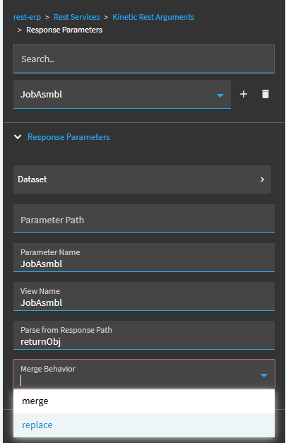

Not sure if you’re in Classic or Kinetic, but in App Studio…
Without knowing more about what you’re doing/calling, etc. this setting came to mind. This is on the Response Parameters where you can either merge the response with (I’m assuming, previously returned data) or “replace” the previously returned data with the newly returned.
Have you played with that setting at all? I’m not sure what the “default” merge behavior is, if you don’t select something here. Curious if you set this to replace if you may get better behavior for your particular use case.

I’m using Kinetic 2022. I tried both merge and replace. When neither worked, I enabled developer tools in Edge and looked at the network traffic. I clearly see the Execution Parameters are changing, but the response is not.
