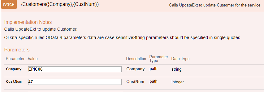

Getting the following Error while trying to a update Customer using rest api.
{“HttpStatus”:500,“ReasonPhrase”:“REST Api Exception”,“ErrorMessage”:“Expected literal type token but found token ‘EPIC06’.”,“ErrorType”:“Microsoft.Data.OData.ODataException”} any idea? cc @josecgomez
What’s the call?
The values for COmpany need to be quoted.
thank you resolved. I was tried with double quote but it should be single quote.
