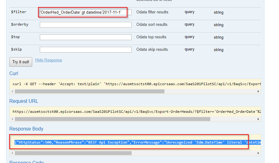

So if I try the datetime trick
$filter='OrderHed_OrderDate' gt  datetime'2017-11-1'
I get
{"HttpStatus":500,"ReasonPhrase":"REST Api Exception","ErrorMessage":"Unrecognized 'Edm.DateTime' literal 'datetime'2017-11-1'' at '24' in ''OrderHed_OrderDate' gt datetime'2017-11-1''.","ErrorType":"Microsoft.Data.OData.ODataException"}

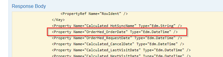

Looking at the Meta Data it does show that OrderHed_OrderDate is a Date…

looks incorrect, probably just a typo here?
Yeah there’s another quote , the site ate it
It wants -YYYY-MM-dd exactly,
That is OrderHed_OrderDate gt datetime’2017-11-01’
ok So removing the quotes from the Left Side and adding the extact format as you showed works…
