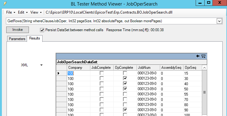

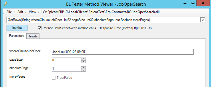

Here is a screenshot of the BL Tester, the JobOperSearch.GetRows should return the same result as https://server/epicortest/api/v1/Erp.BO.JobEntrySvc/JobOpers?$filter=JobNum eq ‘000123-09-05’

Well in BL Tester you are using a different BO though. There you used JobOperSearch in the API you used JobEntry. Can you test again using the JobEntry BOs
