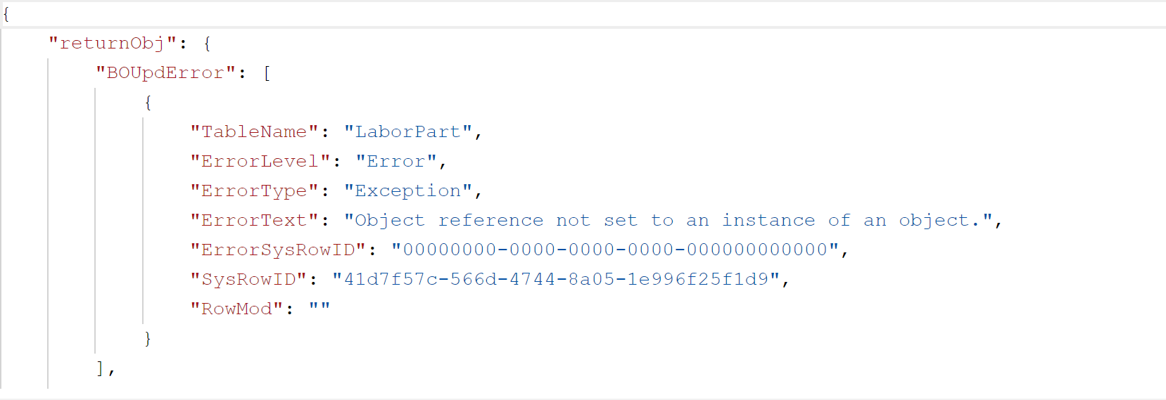

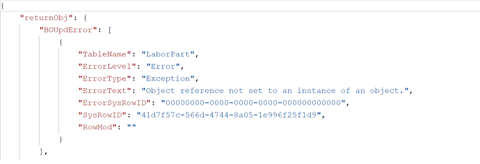

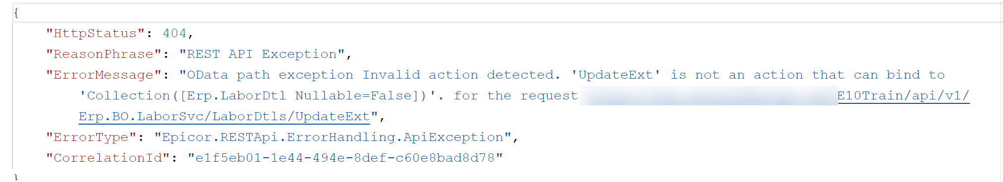

Here’s one error I’m getting.
Also getting the always helpful: object reference not set to an instance of an object

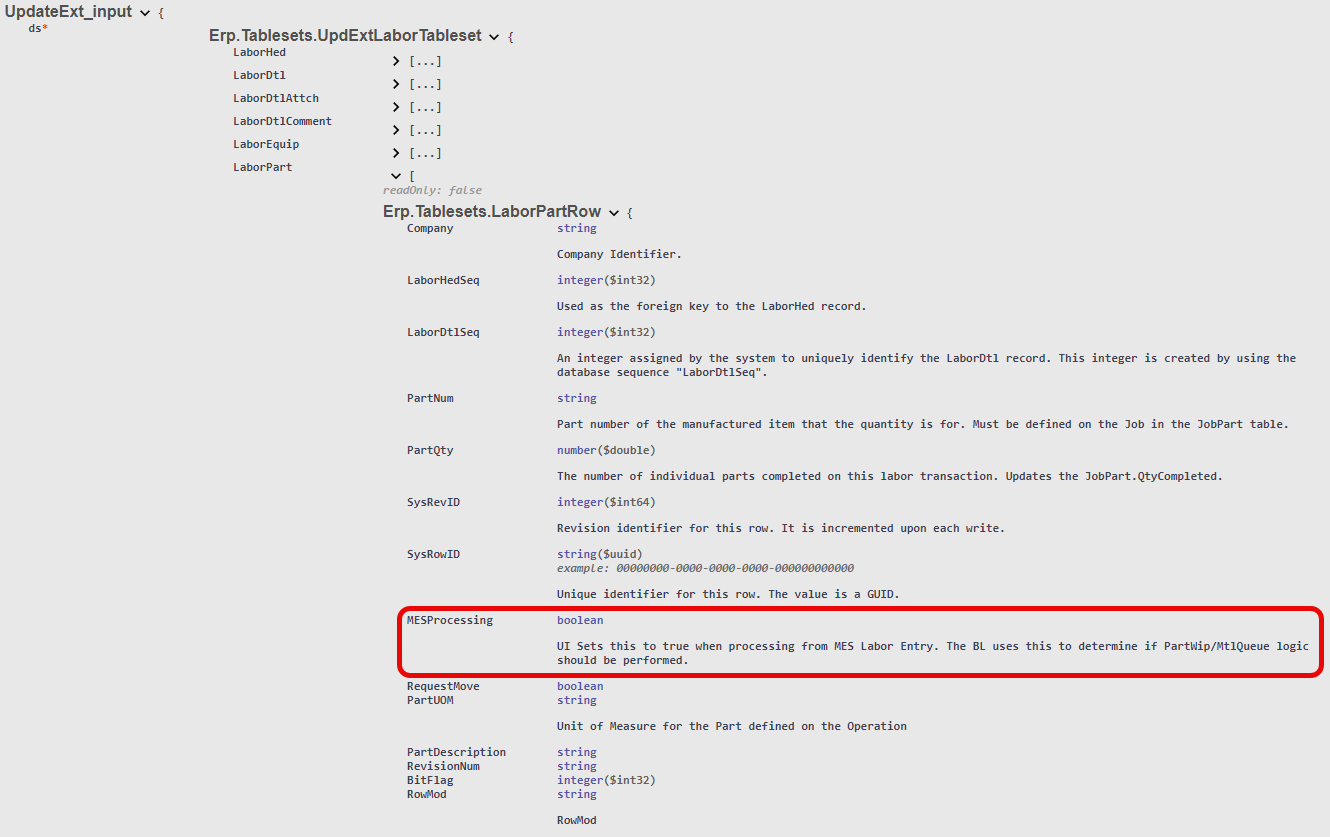

It seems you need three main sections in the REST call, LaborHed, LaborDtl, and LaborPart. I’m setting them as shown on the Swagger help page but alas it’s just a big failure.
