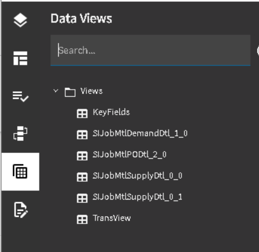

Add a dataview called “KeyFields” to your receiving dashboard layer.
Initialize it after form load.
Then you can send it in the URL and it will receive it.

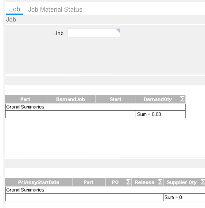

Thanks! So I have a basic dashboard with tracker view. A single prompt field “JobNum”.

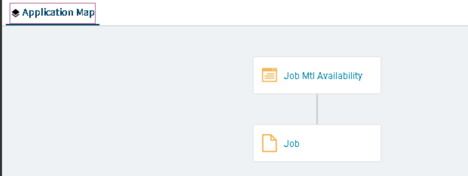

In App Studio, the app looks like this…

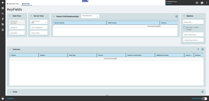

As your post describes, I simply added the dataview.

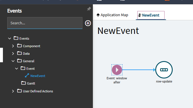

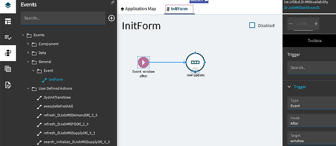

I didn’t add any columns. I did add the Window Load event method…

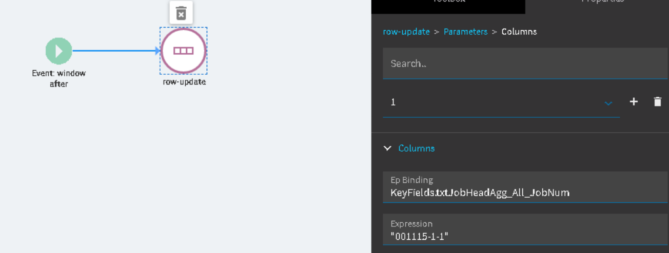

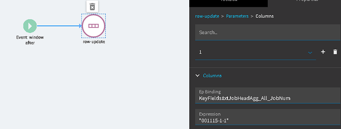

But as far as the Row-update, I was completely guessing as to what was supposed to be going on there. Following the images in your post, I constructed the following:
I chose to specify an actual value as a last resort - this didn’t retrieve the desired results, either. The EpiBinding uses the field name that was assigned to the prompt…
So, I threw this together without really know what needs to be connected to what in order for it to work.

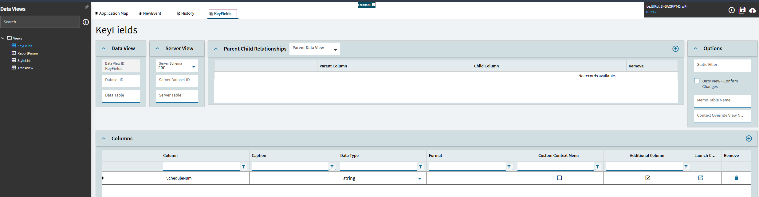

My guess is that I have to add a bit more definition to the KeyFields dataview. At present, it’s just ‘hanging out there’ unrelated to anything else.
Nah, mine is empty.

How did you decide to call the column in KeyFields PartNum? Arbitrary?
And does your dashboard have a prompt field (with a name)?
Thanks.
Yup. That just happened to be what I used off the top of my head.

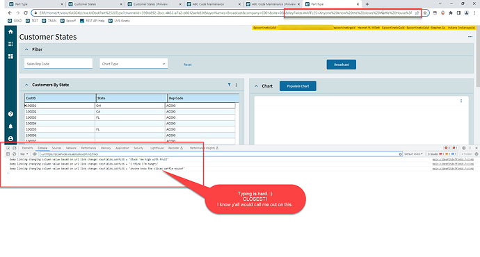

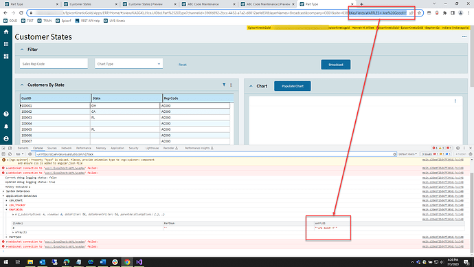

See below for an even more arbitrary column name.

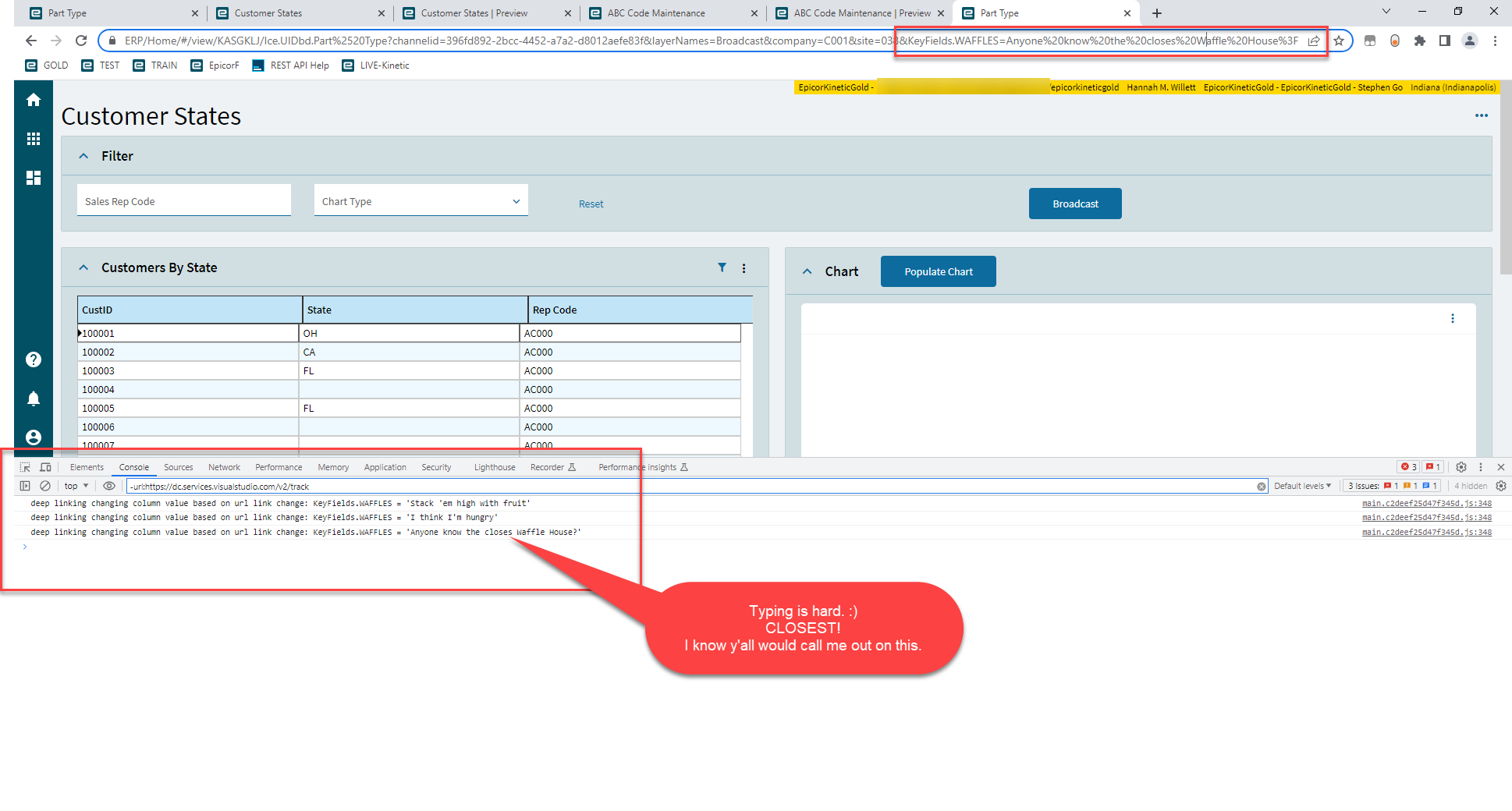

I mean, it has some unrelated ones from this test. Initially, I bound KeyFields.PartNum to a textbox for demo purposes, but I removed it and you can see it still working.

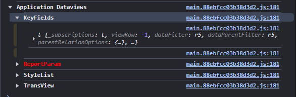

If you have Dev Tools Open and Debug Mode active, you should see the deep linking column change message.

Lol, it’s my layer name because I was playing with the broadcast event. Not to be confused with ?Broadcast=1 which allows for inter-app communication on the broadcast channel.
