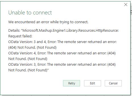

So my ongoing challenges with Odata continue.
You may not be aware, but Excel has 2 oData drivers, a legacy and a new one. The new one is the same as used in power bi.
https://ausmtssc001.epicorsaas.com/SaaS205sc/api/v1/BaqSvc
Should result in a catalog with a schema of BAQ’s under proper REST guidelines.
If you put this in the legacy driver, excel will return a list of BAQ’s and you can select one OR MORE and pull them into a data model.
If you use the newer driver, you get a 404 Error. I tried it with a datawarehouse tool that used the cData driver and get the same 404 error. Their analysts looked at it and said Epicor isn’t properly supporting the $metadata tag on the service.
IE something like this should work but doesn’t: https://ausmtssc001.epicorsaas.com/SaaS205sc/api/v1/BaqSvc/$metadata
When you access a BO with odata, you are properly getting the schema of all the available tables, but NOT when you use the baq service.
I’ve testing this on 10.2.300 and 10.2.400 with the same results.
Anybody else able to, in excel (o365 version), go to Data>New Query>From Other Sources>from OData feed and put in something like this:https://ausmtssc001.epicorsaas.com/SaaS205sc/api/v1/BaqSvc
And NOT get an error??

But you can’t do one Rest call and pull in multiple BAQ’s into excel like you can with, for say, a business object which has multiple tables
Why can the legacy excel driver show you the list of all baq’s and you can select 1 or more and they come in as separate tables?
The new driver throws in an error

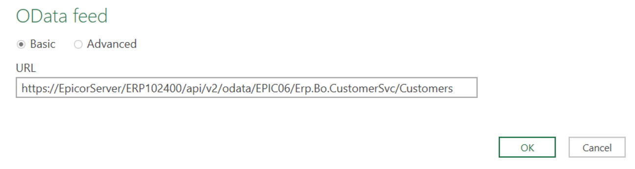

  1. REST Service Root URL has changed the format to include the current Company. The /api/v1/ segment of the request URL has been replaced with /api/v2/odata/.
  2. The format of Business Activity Queries (BAQs) data requests has changed to include /Data in the request URL. This is critical for enabling REST API compatibility with Microsoft® Excel® 2016/365. Refer to the BAQ Feeds topic of this guide for detailed information and examples (Display Data in OData Applications Display in Excel Table).
https://[EpicorServer]/[ERPInstance]/api/v2/odata/[Company]/BaqSvc/[BaqName]/Data?[baqParam1]=x&[baqParam2]=y
For the URL, enter the resource you wish to display in this Excel spreadsheet.
https://EpicorServer/ERP102400/api/v2/odata/EPIC06/Erp.Bo.CustomerSvc/Customers
The following URL can be used to display data from the Customer Contacts Business Activity Query:
https://EpicorServer/ERP102400/api/v2/odata/EPIC06/BaqSvc/COM-CustContacts/Data
Example $metadata
https://EpicorServer/ERP102400/api/v2/odata/EPIC06/Erp.Bo.CustomerSvc/$metadata

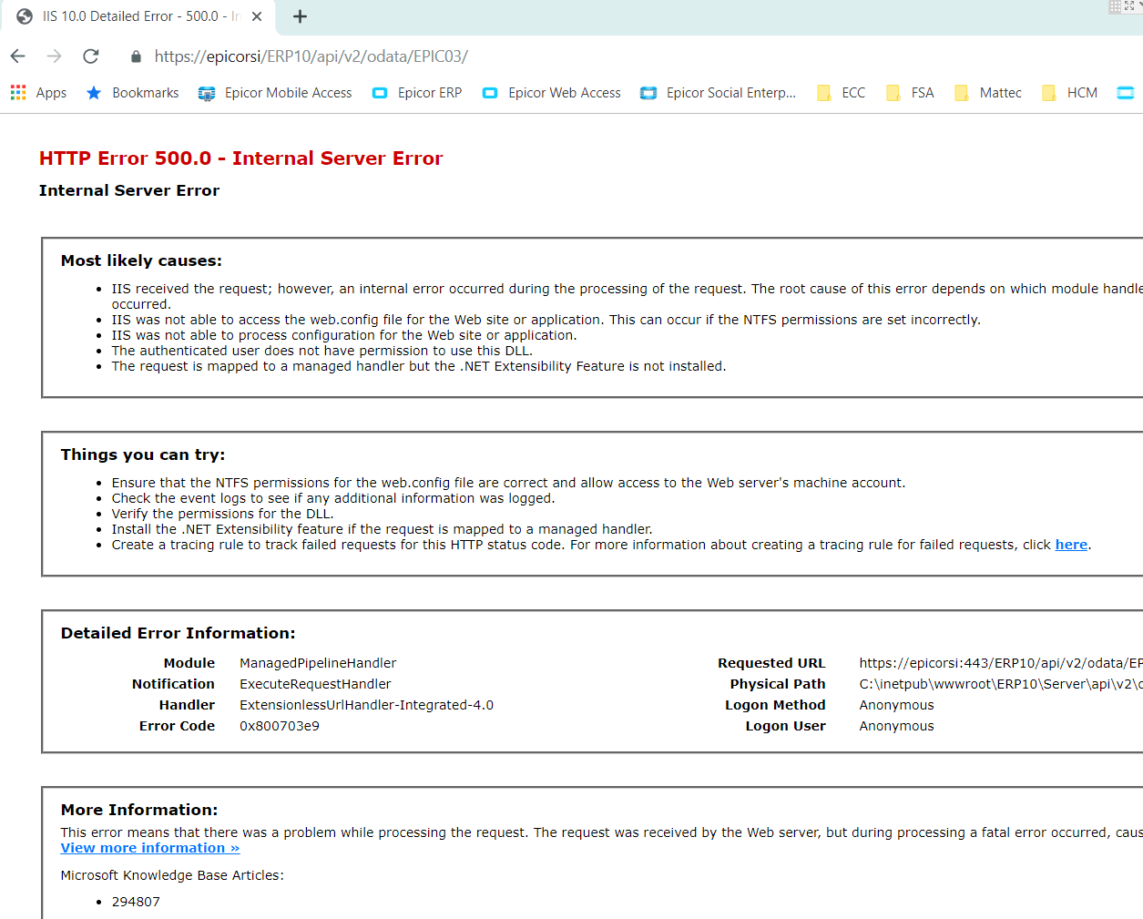

So trying all these V2 links throws an internal server error (i.e. V2 isn’t running). I’m running 10.2.300.
Does something need to be done to enable version 2?
See attached screenshot
v2 is for 10.2.400 - Since you mentioned it on top I assumed you were on 10.2.400.

This worked on Monday but not since. I had the screens pop up as in the example.
odata%20issue
I have attached the error I get. This is within Production or Pilot and as MArk mentioned we are a SaaS
Did you try that legacy driver option?
Yes Mark and says its trying to pull a list of tables
