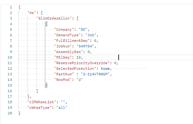

Trace logs shows hundreds of fields in the dataset. I’m trying to do it with POSTMAN and I can’t fill in all those fields because I will only know a bit of data on my webpage about the item that’s in the fulfillment log. I won’t have the entire dataset.
Server shows this error:
I think it means that I’m not passing a field that’s needed, however it doesn’t explain which one. Which field do you want Epicor?! Kramer’s voice: Why don’t you just tell me the field you want to see?
It looks like the error is coming from a Post-Processing BPM related to a Web Endpoint. It is coming from the constructor of a Uri, and is being passed a null instead of a valid string.

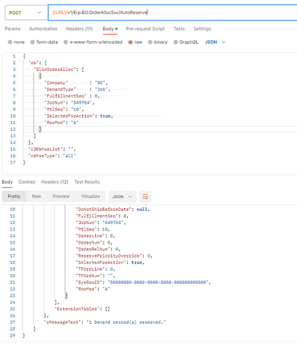

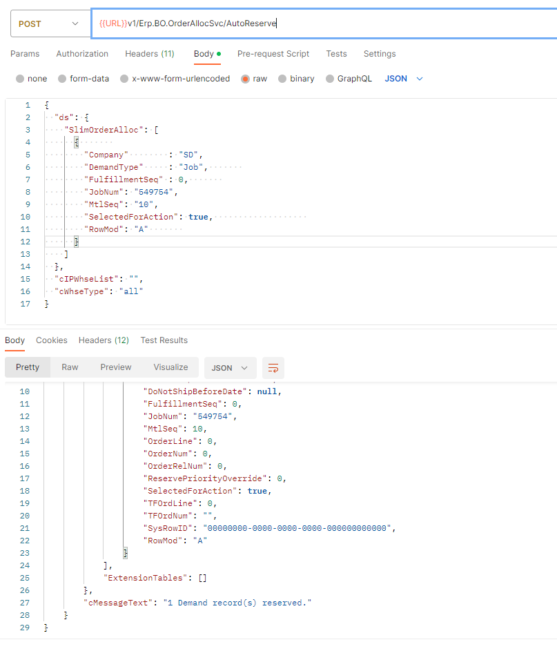

In case anyone is wondering how to do the actual reservation I got this tiny payload working:
But I can’t do the reverse of that with the unallocation / unreserve endpoint. which is the reason for this post. I ran a trace log and got the xml for the entire request out then converted that to JSON with an online convert tool and then tried to run that as my “ds” but get the same error as when I tried with the SlimOrderAlloc.

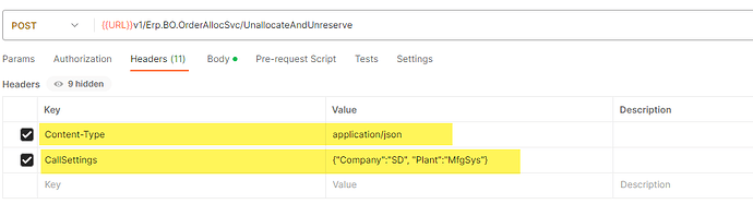

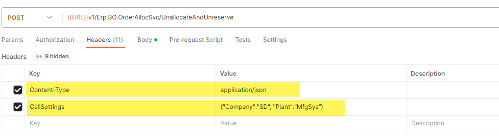

Also make sure your call settings in POSTMAN are set to something like this:
