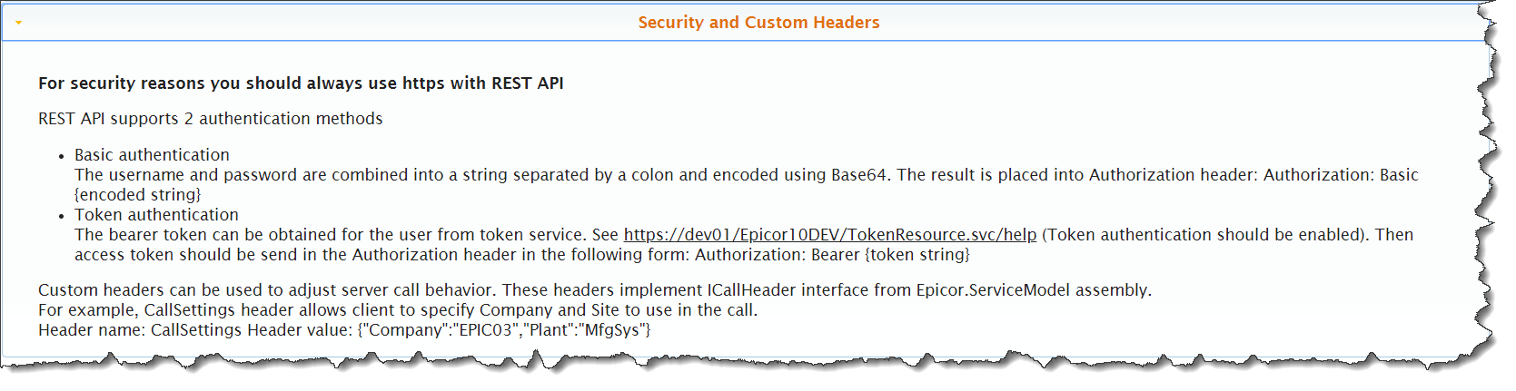

Did you try setting the custom call header?
from the swagger UI:
I am using basic authentication. I will try to add CallSettings to my CURLOPT_HTTPHEADER => array(). I will also add my full test code which is working with Company A. The failure happens when I try to change the Postfields to include the companyB.

Try something like this
Review how to setup that custom header and try to add it to every call with correct company.
@Olga @Aaron_Moreng that was the solution! Thank you.
I added this to the CURLOPT_HTTPHEADER => array( and it did the job!
‘CallSettings: {“Company”:“25558B”}’,
