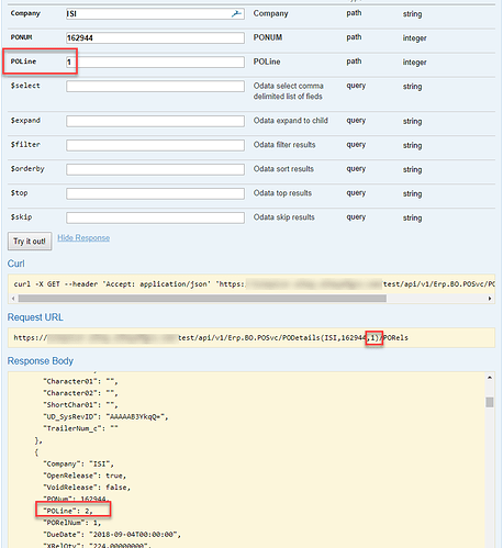

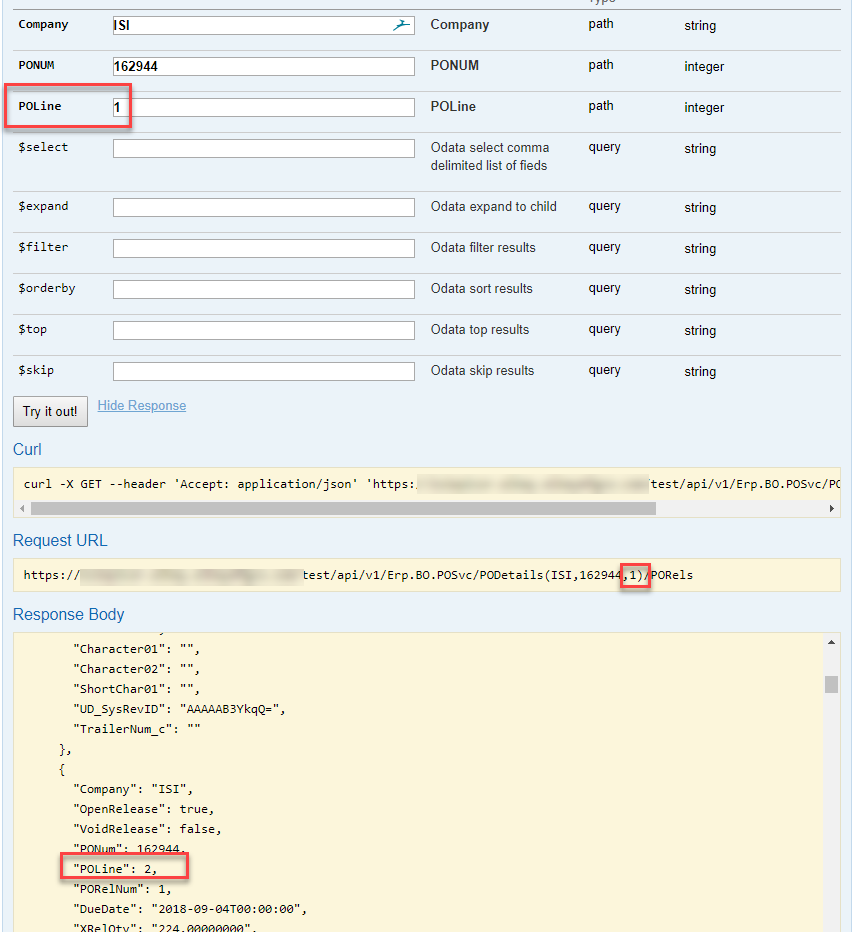

I’m playing around with pulling the PO Releases in Swagger and I’m trying to get all of the releases for a single line, but it’s pulling back the releases for ALL lines. Why is that?
https://<fqdn>/test/api/v1/Erp.BO.POSvc/PODetails(ISI,162944,1)/PORels

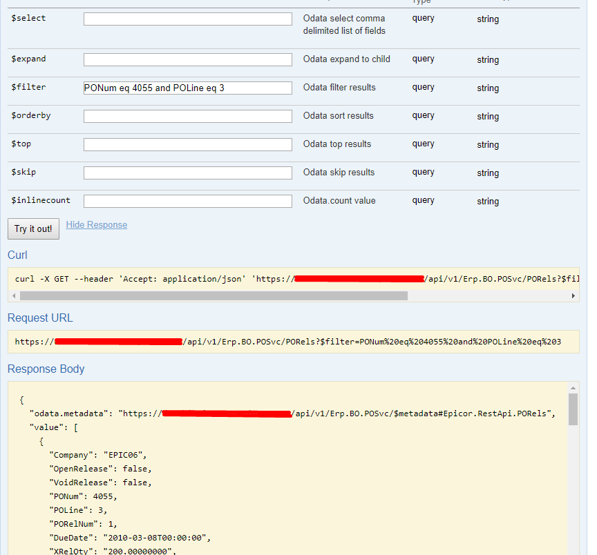

Rather than using the POSvc/PODetails to get PORels, I would simply use POSvc/PORels and add a $filter condition for PONum and POLine
You can also play with the expand command if you need parent child
