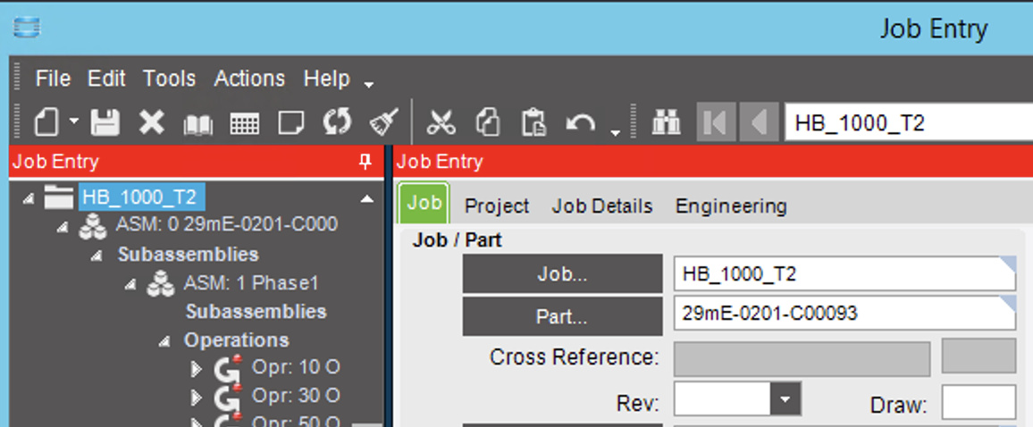

I have a Job (HB_1000_T2) with Operations.
Using the Erp.BO.JobEntrySvc/JobOper service…
I run a simple query using the Job Number in the filter…
Notice that even though there are Job Operations in the system, the Rest query returns no data.
But when I put a high enough value in the top function of the query, values get returned…
