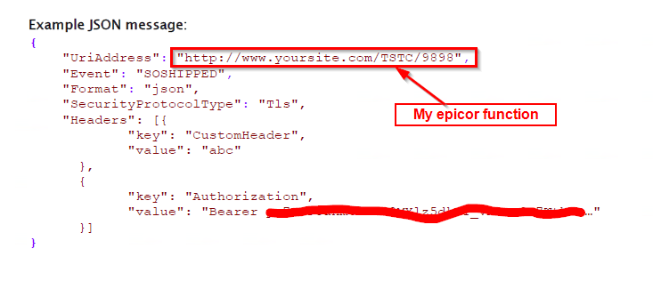

Here is a subscription example for it:

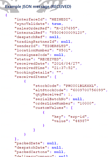

And here is the response example:
Again, If I could have the response as a string/dataset/array/whatever variable in my function it will solve my problem.

That’s the problem the webhook “data” is not a simple flat dataset it has keys and subjeys and arrays you cannot get that into an Epicor function. Without some middleware’s help.
