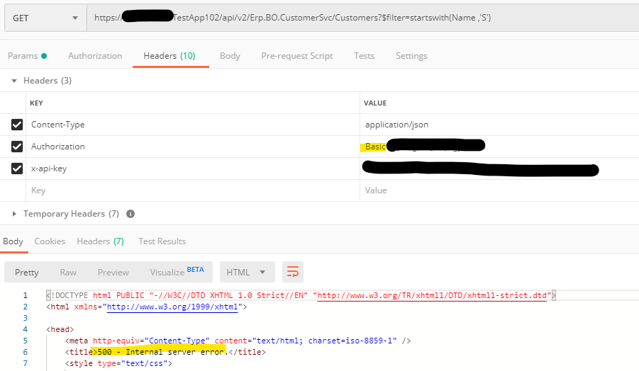

after try several time and research on internet, I just arrived to the conclusion that I still need to use the Basic Authentication and api-key for REST V2.
Using POSTMAN, try to use the same structure as my URL, you will get the following
401 - Unauthorized: Access is denied due to invalid credentials.
then go to Authentication and add your user and password and you will be able to get the result
now, if you remove the api-key from the URL

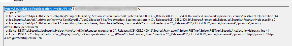

It got me thinking. The documentation is a bit vauge about access scope, so just in case it was a situation where no access scope is equivalent to deny all, I tried to create an access scope for all, but got the spinner of death when I tried to add all services.
I then tried recreating the API key, just in case I copied it incorrectly, and recycled the APP pool, That appeared to work.
In summary I ended up
Delete and recreate a new API key (only populating the keyid, name and decription leaving all other options as default.

Applying the api-key into an environment variable in Postman and included basic authentication using an account that is not setup for single sign on.

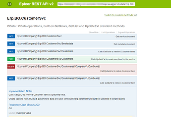

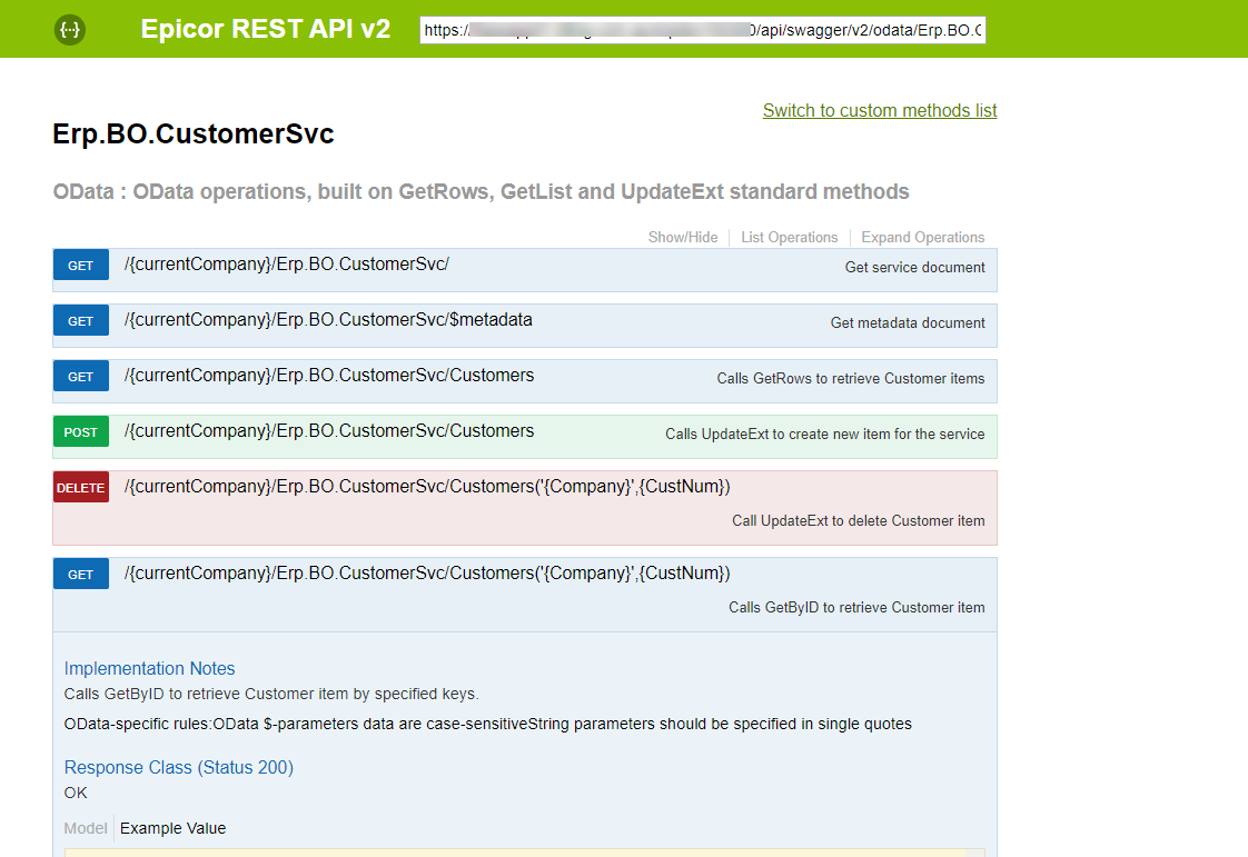

To validate that I had things configured in postman correctly I executed the request using the Swagger REST API v2 web page on the app server.
