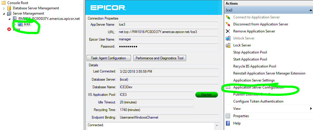

In Admin Console, the app server configuration:
Opens the config page with the database tab - including a test button.
I assume that is the question?
