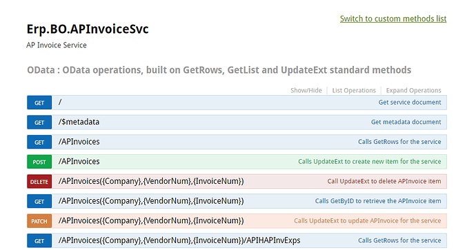

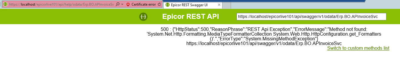

So, I recreated the app server twice and enabled REST services, but continue to get this message when trying to browse to service. Anyone have any other ideas of something to check?
I’ve noticed that some services are big hairy and complex and swagger chokes on rendering the help screen for them.

This is happening with all services.
I have it working on a test server running 10.1.500.17, but cannot get this working on the production server.

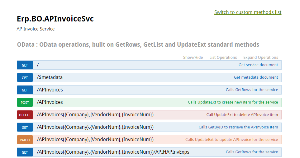

I re-created the app server and tested REST services, worked fine.

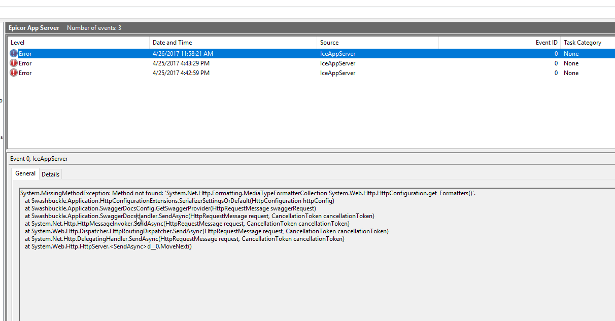

Figured out the cause at least, for whatever reason, the error is caused by a file(s) in this folder.
Server\Customization\Externals
Maybe you are causing a name crash. What are your DLL’s inthere?
This dll is causing the problem.
System.Net.Http.Formatting.dll

That’s a pretty popular extension I’d image that Epicor REST is using it and this is causing a version crash because the External’s folder is in the same APPPATH.

Doing this allowed my REST API to work again, and my External DLL worked too

That did it, thanks Jose!
