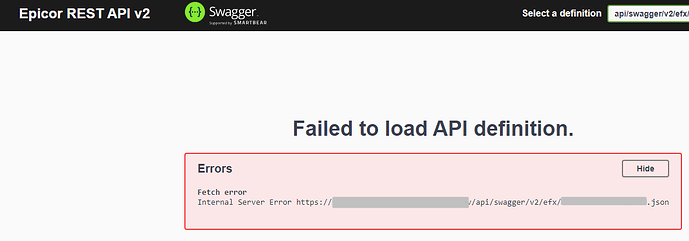

I’ve been tasked with adding a new function to an existing library. During dev I’ve turned to the Swagger to test but the Swagger fails to load API definition for this particular library. And only this library - all others work as normal. I get this:
We run three instances on prem - Dev, Test and Live. So I tried Swagger on the other instances and get the same thing. Only this one library seems to error, all others work as usual. Any idea what’s going on here? How have I broken it this time? :blush:

I think you might be onto something here Olga.
Ice.Common.EpicorServerException: Failed to generate Schema for type - Erp.Tablesets.QuoteTableset. See inner exception
—> Swashbuckle.AspNetCore.SwaggerGen.SchemaGeneratorException: Failed to generate Schema for type - Erp.Tablesets.QuoteTableset. See inner exception
—> Swashbuckle.AspNetCore.SwaggerGen.SchemaGeneratorException: Failed to generate Schema for type - Erp.Tablesets.HedTaxSumTable. See inner exception
—> Swashbuckle.AspNetCore.SwaggerGen.SchemaGeneratorException: Failed to generate Schema for type - Erp.Tablesets.HedTaxSumRow. See inner exception
—> System.InvalidOperationException: Can’t use schemaId “$Erp.Tablesets.HedTaxSumRow” for type “$Erp.Tablesets.HedTaxSumRow”. The same schemaId is already used for type “$Erp.Tablesets.HedTaxSumRow”
at Swashbuckle.AspNetCore.SwaggerGen.SchemaRepository.RegisterType(Type type, String schemaId)
at Swashbuckle.AspNetCore.SwaggerGen.SchemaGenerator.GenerateReferencedSchema(Type type, SchemaRepository schemaRepository, Func`1 definitionFactory)
at Swashbuckle.AspNetCore.SwaggerGen.SchemaGenerator.GenerateSchemaForType(Type type, SchemaRepository schemaRepository)
at Swashbuckle.AspNetCore.SwaggerGen.SchemaGenerator.GenerateSchema(Type type, SchemaRepository schemaRepository, MemberInfo memberInfo, ParameterInfo parameterInfo)
— End of inner exception stack trace —
