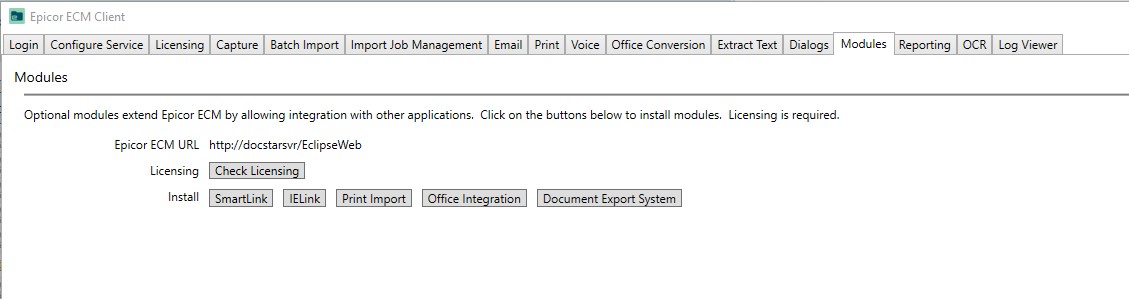

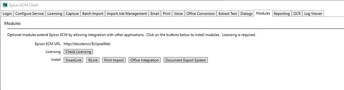

We have an desktop app called Epicor ECM Client downloaded on each Epicor Users PC (6 users total). The app is logged in with each user’s Epicor profile creds. Within the app there’s an option to download and install the ‘Office Integration’ module. After install, in all O365 programs there’s an Epicor ECM category on the top of the banner.

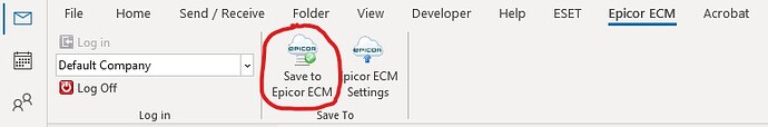

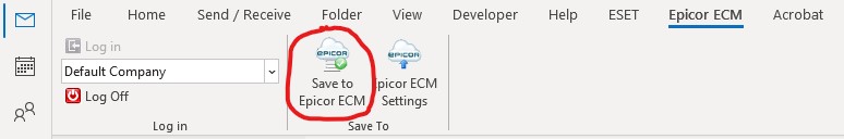

Click on the ‘Save to Epicor ECM’ button, and a window prompts users to select WF, Content Type, Security Class, etc for each document. Click send, and within a minute it’s in the Workflow Queue in ECM waiting to be processed.
