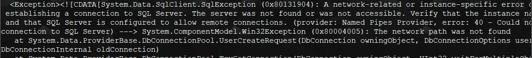

What messages are you getting in the event viewer when restarts are failing?
I got this when I bounced the test db server just now.

That looks like the error we see. Unfortunately our Epicor application server won’t autostart, as an example I installed some patches last week on both servers(SQL and Application server) and didn’t realize it was auto-restarting. The end result was Epicor was offline until I realized what happened and opened IIS on the application server to stop and start the application pool. My hope is to find a solution so IIS will try to autostart the application pool, and if SQL is offline it will attempt periodically until it can start the application pool.

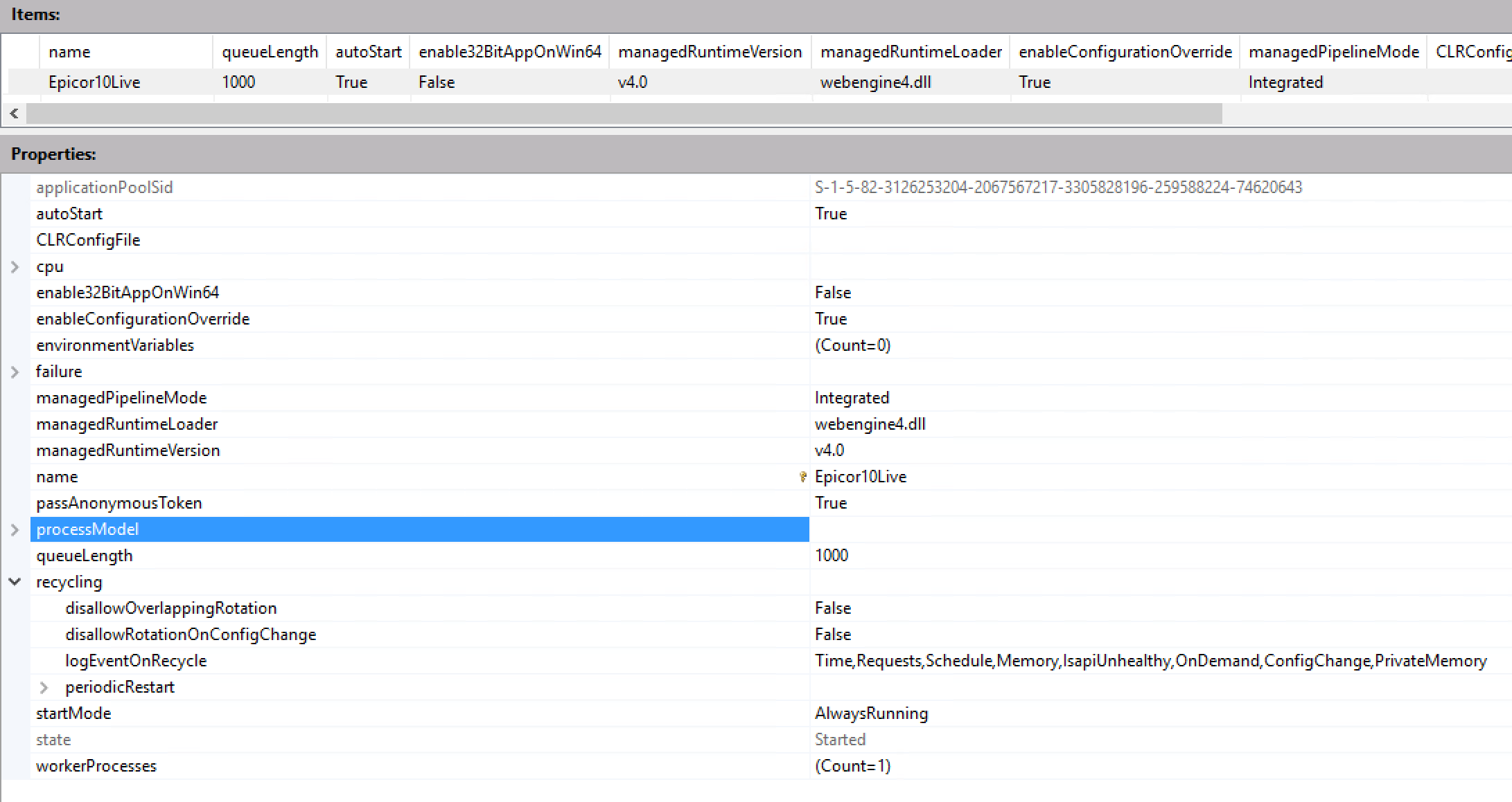

Here is the app pool configuration. It’s set to autostart and alwaysrunning which is what I thought controlled this but keep in mind I’m very unfamiliar with IIS.
I have always used a domain service account for the app pool and the 12 instances of Epicor I have all auto start without issues.
