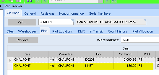

And it shows in Part Tracker
There are a few places where it appears to not be on hand (like in Inventory Transfer), but it really is.
The following is with 130 FT in the NNET bin
It looks like there is zero there, but if you searched for that bin you’d see:
