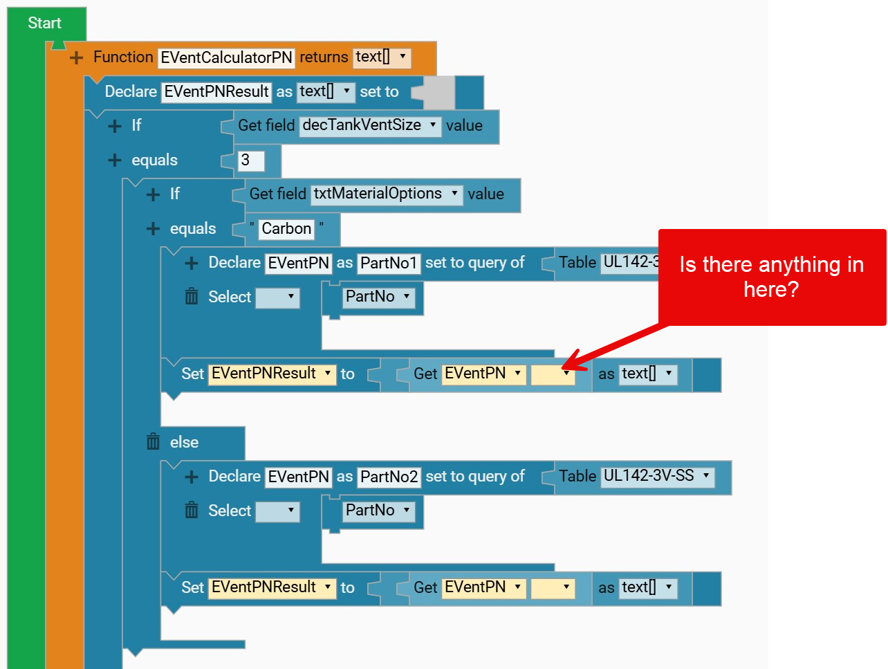

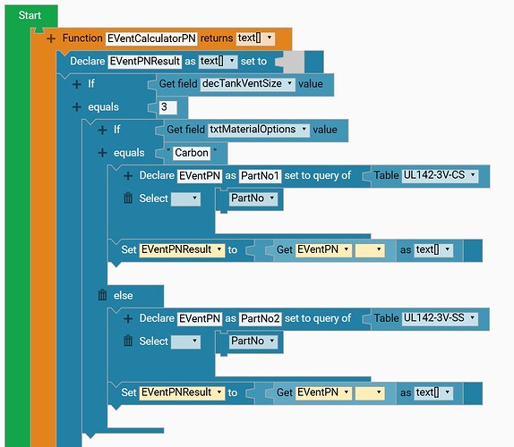

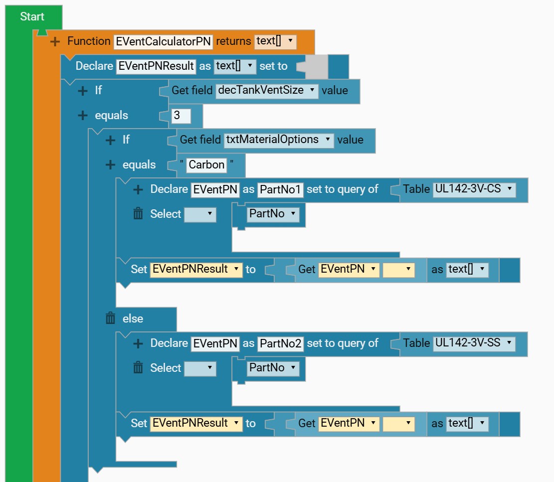

Thanks for the reply. What I do is I pull in the data as an array and then use a For loop to iterate through the array. It works fine, but it comes as the Column Name: Value. So I ended up having to do a Replace on the Serialized to JSON string to arrive at my values. I’ve got it working but I thought there must be a better way to extract the actual value from the array. I can only put one image in a post as a ‘new user’. Function below in reply.

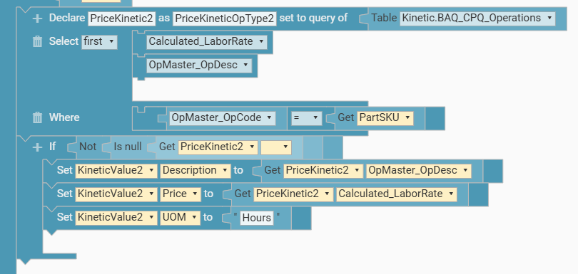

Here is an example:
We don’t have to remove any text from this result, we have a WHERE statement. Not sure if that might help your situation? Could it be returning the header row?

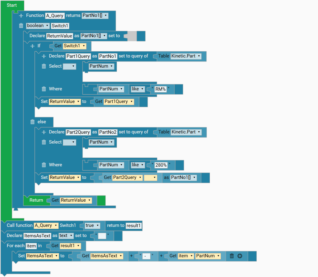

You need to create the function to return that query a bit differently.
You want the return type to be the same as the type created by one of the queries.
When you try to set the return variable to the results of the 2nd query you will get a ‘Cast Type’ error, if you click the option to fix it and cast as expected type it will make the lock to set it as the unique type from the first query.
Then when your results are returned from the function they will work the same way as making a query elsewhere in your configurator.
