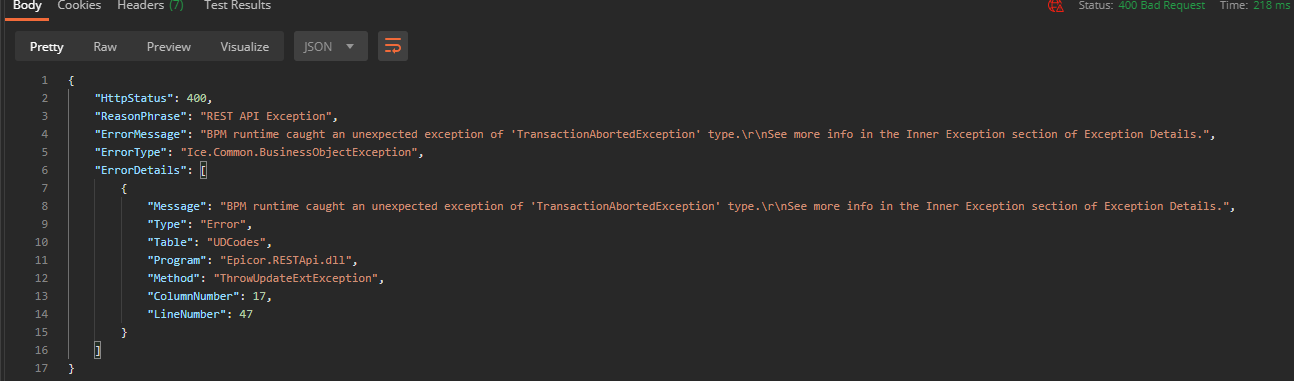

Hello. I have a BPM that is triggered by REST. It was originally set up by an Epicor consultant, but we’ve had to make some changes after the fact to change days to business days. These changes are working fine in the test environment, but in the live environment using the updated version of the BPM gives the following exception:
“BPM runtime caught an unexpected exception of ‘TransactionAbortedException’ type.\r\nSee more info in the Inner Exception section of Exception Details.”
The issue is that since the BPM is not giving an exception in the ERP, but rather only when triggered by the REST API, either by Postman (for testing) or by an app which was written by our web developers. I cannot figure out how to find any of the Exception Details to try and figure out anything more specific about what is going wrong.
Is there any way to find details for an exception that has previously happened in a situation like this? I’m only really looking to find out the details I would need to troubleshoot right now, but I can post BPM code as well if necessary.
Look in the event viewer on the server. there are more details probably
Ah thank you, I think that did work! Now I just have to decipher this error :upside_down_face:
and what does it say? :slight_smile:
