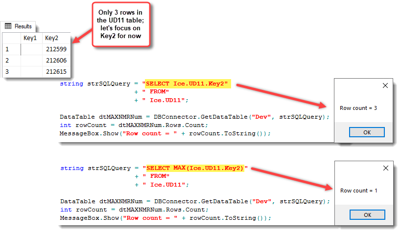

As I’m thinking about it, I might have (during my previous attempts above) incorrectly assumed that I could fill a DataTable object and retrieve the value directly from the DataTable (my knowledge of C# isn’t on an expert level at this point). Of course, with the method José provided, this is all moot - however, I still want to understand where I previously took a wrong turn.
If I can get record counts in the following manner (ignore the “DBConnector” method because that merely does the work of connecting to the database and returns a DataTable according to the passed query):
… then what is the correct way to reference and return actual field values, such as “Key2” in this case, from the DataTable object? I wasn’t able to return a value, which means I must not have been referencing the column/field correctly.
Again, this is merely so I can understand my error.
EDIT : It makes sense that a data view would not have returned anything because I didn’t have anything on the form, at that specific time, to reference in the view. However, a simple call to the database using a SQL connector and filling a DataTable object should have worked.
