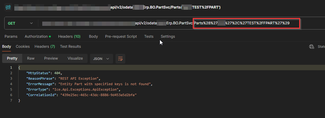

Discussing internally hold please. Concern is will a blanket encode break the rest of “Parts(‘{Company ID}’,‘{partNum}’)”
It does indeed freak it out. Will have to self encode the specific variable getting passed in.
As Josh said we can’t encode it for you because only a portion of that parameter should be encoded I would recommend though instead of doing a replace that you use HttpEncoding library as shown
string companyID="MfgSys";
string myCrazyPartNumber="My/Parts/Are/Crazy/Long/And/Have/Slashes/In/Them";
var response = EpicorRest.BoGet("Erp.BO.PartSvc", $"Parts('{companyID}','{System.Web.HttpUtility.UrlEncode(myCrazyPartNumber)}')");
