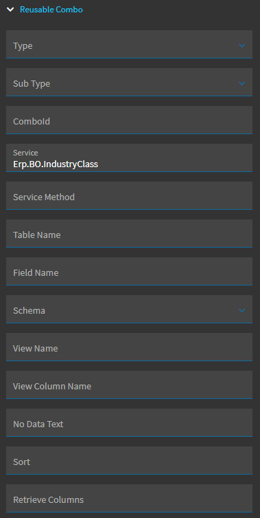

So far I’ve created a UD Combo-box, regenerated the UD columns and did the EpBinding. Here is what I have in the Reusable Combo section of application studio based on the Application Studio user guide.
I’m an Ops focused person, not IT and would appreciate any advice in easy to follow terms.

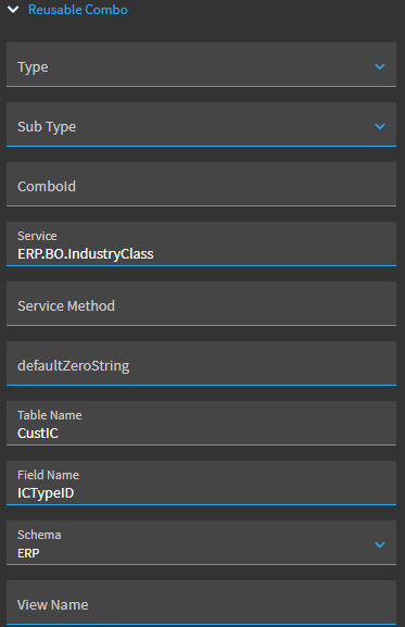

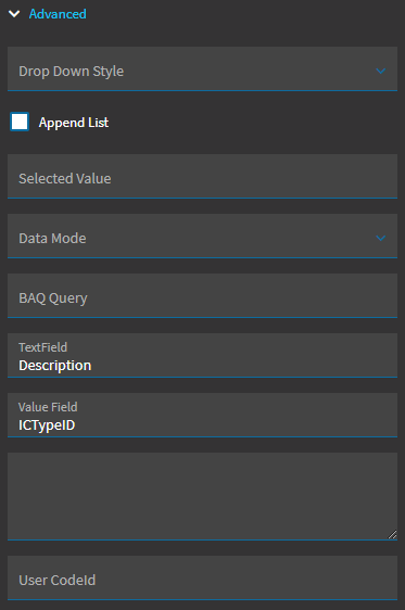

The Industry Class dropdown on the Customer screen looks like this:
Maybe you could start there and get it working, then modify to your needs
This worked perfectly, thank you!
