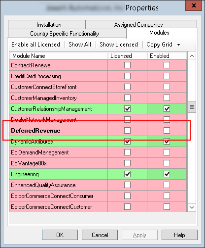

Can anyone tell me if the deferred Revenue is an option that you have to pay for or if it is an option already installed within Epicor. The manual that I downloaded is making it sound like I have to go to eBack Office to get the module to be downloaded. I am just trying to figure out how to turn it on within my Epicor program if you will.
It is a module you need to pay for
