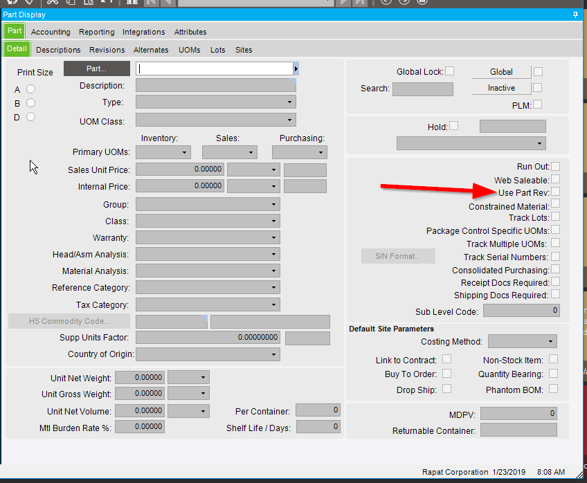

There is a flag on the Part I think “Use Revision” and if ticked I think that tells the system to use the revision specified on the Order, if not ticked I think it uses the latest revision.
Simon
Can you provide a snapshot of this check box? what table/field is it?
I could not find it (10.0.700)

This is where is is @Hogardy. I can’t speak to the use of it though, we just keep everything rev A and do the management outside of E-10.
I did not interpret UseRevision to be UsePartRev… I understood Userevision to be a flag on the revision table to indicate to use THAT revision amongts all approved revisions.
We tick UsePartRev for all our parts… Partrev table has over 30 ud fields, such as package dimensions and weight, parts per package, approved materials to produce the part (list of 5 amongst 100 ) etc… so all information that can be changed and saved as a new revision if needed.

I noticed that your snapshot had info about per container value…
We will soon going into an upgrade process by June to the latest version. Am I guessing right when I say the container is a package of say 30 units?
If so, I can see that (in my opinion) it is missing a weight/volume of the package itself. Multiplying 30 by unit vol and weight is not accurate for us. As the way the parts ,may be packaged together (saving on volume), or that the package could have a palet holding all the parts together. That palet having a volume of 6 sq ft and a weight of 6.8 kg which augment the weight and the volume of those 30 parts.
Unless this info is elsewhere in the part module?
Pierre

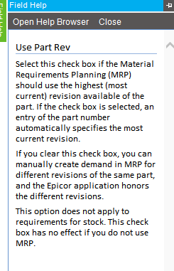

That checkbox is on the Part table, not the PartRev table. So it wouldn’t know which rev was supposed to be “that” revision.
If you look at the help, it seems to mean "Use a specific revision if checked, but if not checked, just used the latest. But it also looks like it only applies to MRP. But :man_shrugging: I don’t know for sure.
That looks like a for reference only field, so I don’t think it will help you without some customization.

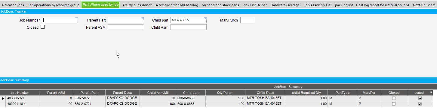

A tool that I have made that has proved invaluable is a dashboard that shows all of the jobs that parts are on. We make nearly everything on a make to order job. It’s a great starting point when looking for anything. Great for revision changes, looking for BOM issues, etc. Plus, you can’t search a job for a material part number, and this lets you do that.
Is that a native dashboard that you may be able to export?
You don’t want the whole dashboard. There’s a bunch of stuff specific to this company. Here’s that BAQ though that this tab is built off of. I just added the tracker in there and moved some of the controls around.
JobBom.baq (41.9 KB)
I appreciate it, I will check it out!
