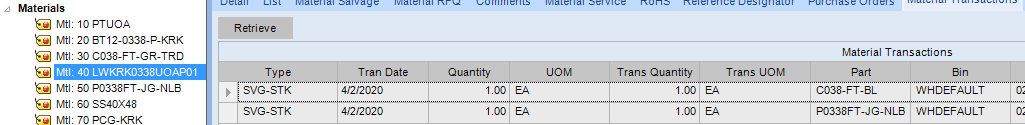

Sorry, should have specified, you have to manually do it with 2 Job Receipt to Salvage transactions. Those closing or veryfying the jobs usually do these transactions. No way to setup the job to automate it this way as far as I know. We load in the job#, select the material from the drop-down and enter the part, qty, etc. of the first part to salvage and press ok. Select the same material from the drop down again, enter the details for the second part I want to salvage, and press ok. As long as the total value of the salvage does not exceed the issued material it will let us salvage.
