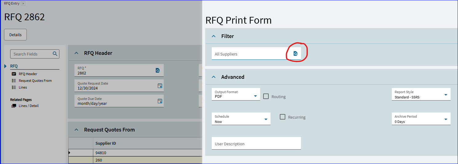

Previously, if you had multiple Suppliers (let’s say (2)) on an RFQ and printed the RFQ, you would end up with (1) PDF with (2) pages, one for each Supplier.
That was a pain, because our Buyers would then need to open the PDF in different software to split it apart.
The work around for us was to “search” for the Supplier on the print screen and the user would be presented with a list of only the suppliers that were added to the RFQ, and they would then print it out once for each supplier. A pain, but it worked.

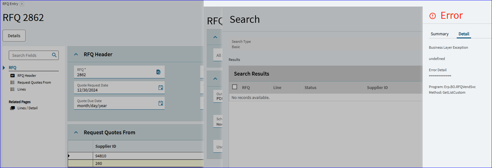

The problem is, now, when they click on the Supplier search on the RFQ Print Form, they get an error:
Just wondering if anybody else has seen this. I will enter a case, but EpiUsers is generally my first stop.

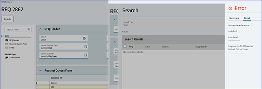

We are facing the exact same issue in 2024.2.9 :frowning:
Per EpiCare support:
This has been reported through PRB0290909 and has been resolved in version 2024.2.10 - here is the ETA for Cloud:
Target Version: 2024.2.10
Estimated Release Date:
Tuesday, February 18 - Wednesday, February 19, 2025 for Pilot
Saturday, February 22 - Sunday, February 23, 2025 for Production
So, hopefully it should be resolved soon.
