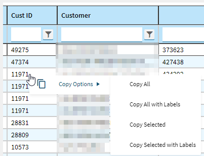

I know this has been discussed before but I can’t quite figure out what is going on. We have many kinetic dashboards where the right click options work just fine. For example, right click on the order num and get the option for Order Entry and Order Tracker. But I have a new dashboard I created and it only has copy options no context options.
I can’t figure out what is different, other than the baq for this dashboard contains reference queries.

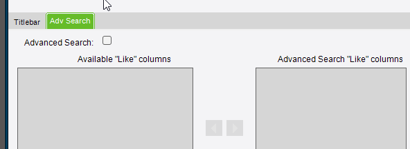

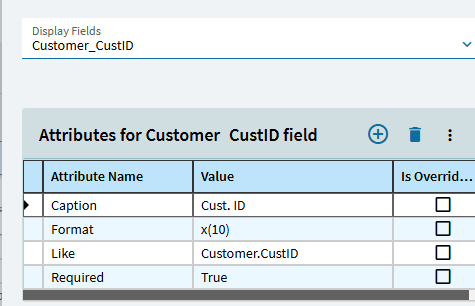

Can you verify the “Like” is set up in your BAQ? Should be if its a native field, but if its somehow a calculated field you may need to set that up.
It appears to be there . . .

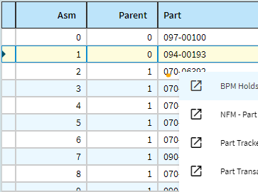

I have seen (MANY) instances of right-clicking on the row that is “selected” results in the defunct context menu:
But if I right-click a row that ISN’T selected, the context menu populates:

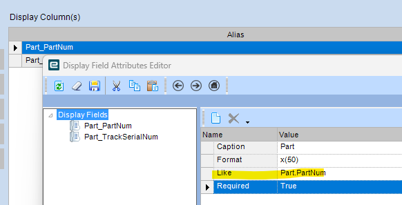

First, make sure the column has the Like property set appropriately in your BAQ.
Then in the dataview, add a Custom Context menu item to the CustID that points to an event with the app-open widget pointing to the Customer Entry app and your customization layer
While that is indeed horrifying, I am getting only the copy options whether the row is selected or not in this case.

I went to double-check where I had done this recently, and adding the Like property in the BAQ got me most of the context menus back
but there was another that opens with app-open (even in base) that I had to add as a custom context menu item
Yeah its strange that the like is there, but still no open with options.
