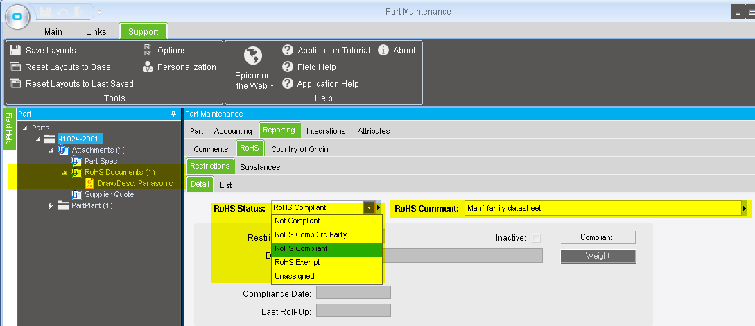

We added two UD fields, one uses a User Defined Code to set one of five possible values. the second is free text that an engineer enters describing why the part is deemed to be compliant of not. We also require the engineer to attach a file to the Part with some backup document.

I think the RoHS is part of standard Epicor, not an add-on module. I added my UD fields to the existing RoHS tab of the Part Entry and Part Tracker, just because it was there and seemed like an obvious place to put the two new fields, but I could have put them on any other screen also.
For our company, there was nothing in the Epicor RoHS functionality that seemed to be useful. And two added UD fields handled everything we did need to track RoHS compliance.
