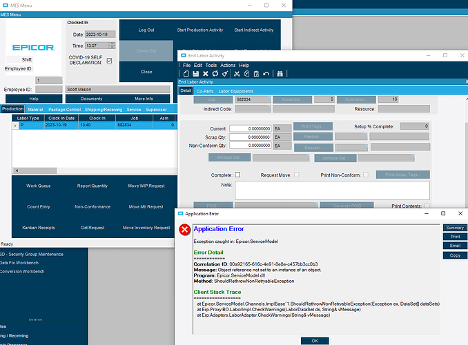

I’m trying to write a REST call that will end activity. I can get it working if all circumstances are good but in case something goes wrong and MES can’t close it normally, then my REST calls also fail. I don’t know what circumstance causes the MES object reference not set to instance of object.
Even in the MES client an error occurs.

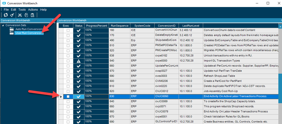

Epicor knows this is a problem so they have a conversion to repair it. The fix is to run User Run Conversion program # 630 and then fill in the job as parameters.
I know it’s a stretch, but how would you invoke this conversion from a REST call with the proper parameters? I want my front end webpage to be able to gracefully end activity even if the MES client errors.

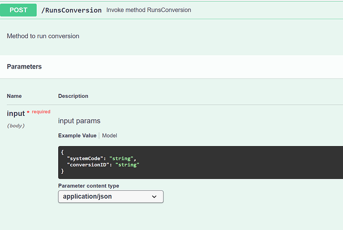

I’ve gotten a little farther. It looks like there is a way to call a rest endpoint to do a user conversion.

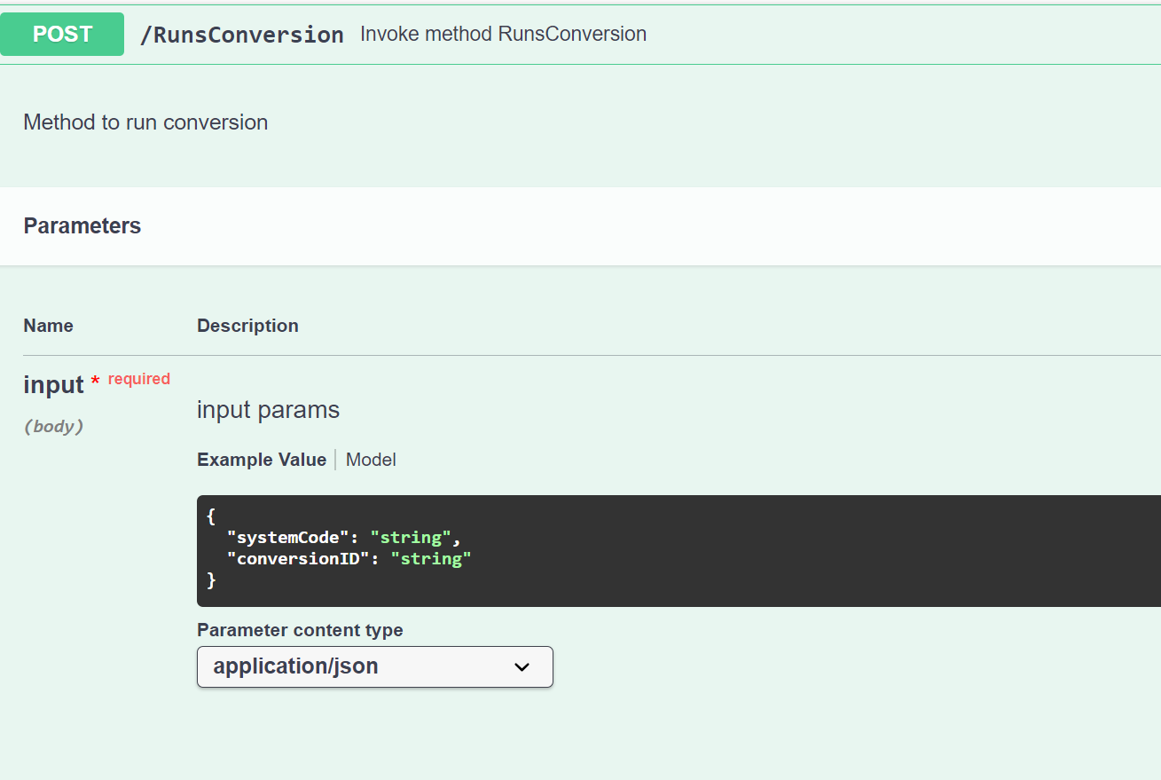

This is what I think the endpoint is: https://servername/E10Train/api/v1/Ice.BO.CnvProgsSvc/RunsConversion
But I can’t figure out the correct parameters even looking at the trace log.

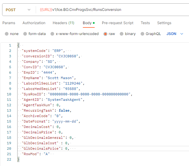

Trying to do that in postman

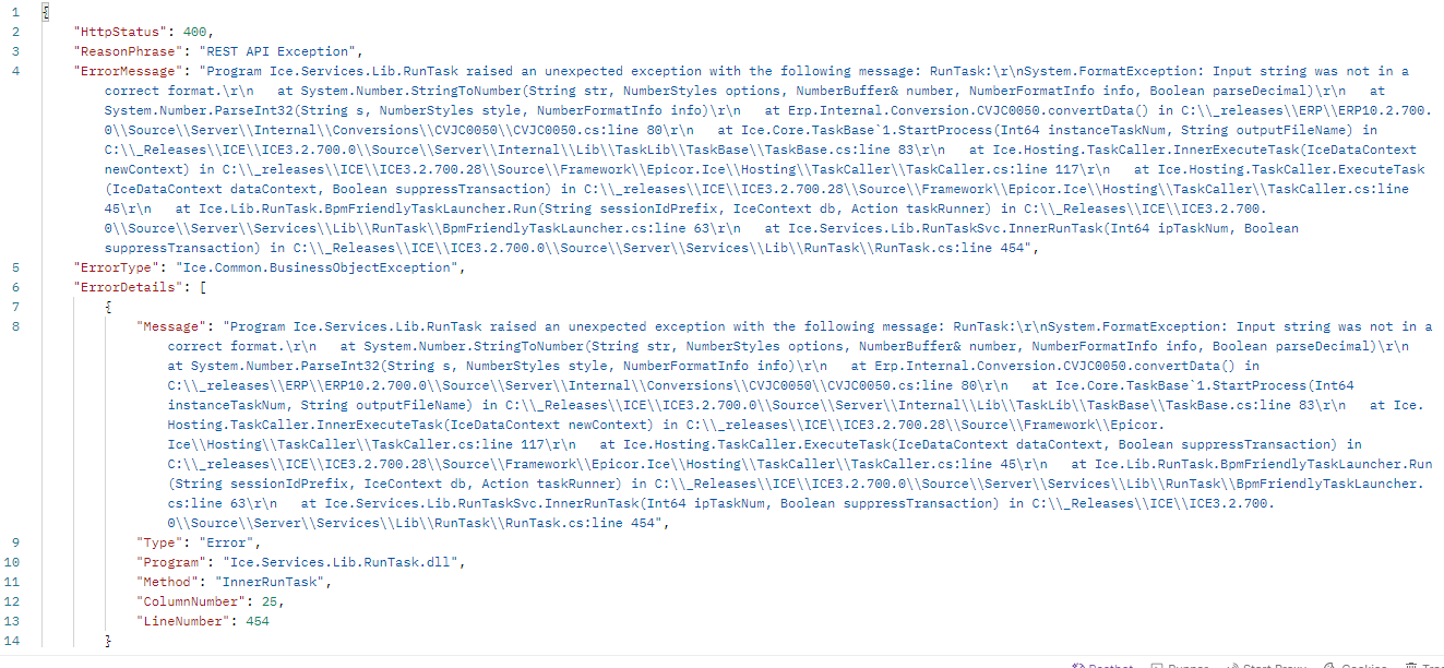

But getting error about input string was not in a correct format:
Does anyone know how I should format the JSON to call the endpoint with the correct parameters I want to send related to a LaborDtl record?
For adds, I usually pass an empty string to the SysRowID, but that’s just a wild guess.
Looks like it’s taking the labor seq’s and a few other data points and then sending it to the task agent. So you’ll need to account for that.
Please tell me you’re wrapping this in a function and not calling these endpoints externally.

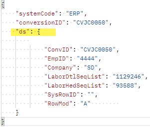

I don’t know if I’m formatting the thing correctly>
Is the JSON like this:
Or like:
Or:
There’s no documentation on it beyond this:
I’m testing this out with POSTMAN so it’s just the endpoint and payload. I would think if I can emulate the JSON it will do what it needs.
I know the LaborDtl and LaborHed sequence numbers and am trying to feed them into the payload, but I guess the consumer of the payload is expecting something else?

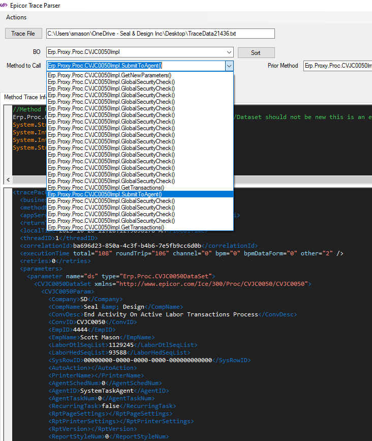

You’re showing the Swagger page method for Ice.BO.CnvProgsSvc/RunsConversion in your last post but your initial trace was ran using Proc.CVJC0050/SubmitToAgent. I would use the latter and drop the SystemCode and ConversionID parameters and use those found in the SubmitToAgent dataset.

Okay so now with this REST endpoint:
…api/v1/Ice.PROC.CnvProgsProcessSvc/SubmitToAgent
    "ds": {
        "CnvProgsProcess": [
                "ConversionID": "CVJC0050",
                "ConvID": "CVJC0050",
                "SystemCode": "ERP",
                "Company": "SD",
                "CompName": "Seal & Design",
                "EmpID": "4444",
                "LaborDtlSeqList": "1129246",
                "LaborHedSeqList": "93588",
                "SysRowID": "00000000-0000-0000-0000-000000000000",   /* blank string produced an error here but all zeros didn't */
                "ArchiveCode": 0,
                "RowMod": "A"
    "agentID": "SystemTaskAgent",
    "agentSchedNum": 0,
    "agentTaskNum": 0,
    "maintProgram": "Erp.UIProc.cvjc0050"

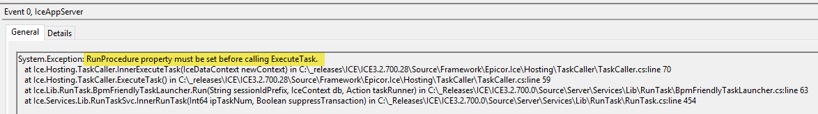

I’m getting an error on the server that says:
RunProcedure property must be set before calling ExecuteTask. I’m not sure what that even means. I searched in the entirety of the trace log text and there is no match for the text “RunProcedure”.
How might I tell REST to set such a thing?
