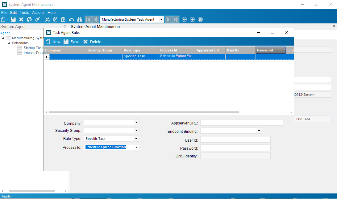

But when in System Agent Maintenance → Actions → Edit Task Agent Rules : I do not see my process set in the list shown at field ‘Process Id’.
What to do?
This is from 2021.2. Does it look different?
This looks the same. I can choose ‘Schedule Epicor Function’.
How do I choose a specific library function?
When you open the schedule epicor function you select the library, method, and params

  • entered my epicor function in ‘Schedule Epicor Function’, choose the according schedule and submitted.
  • in System Agent Maintenance → Edit Task Agent Rules, I have created a new rule, with rule type ‘Specific Task’ , process id ‘Schedule Epicor Function’ and with my secondary appserver url.
