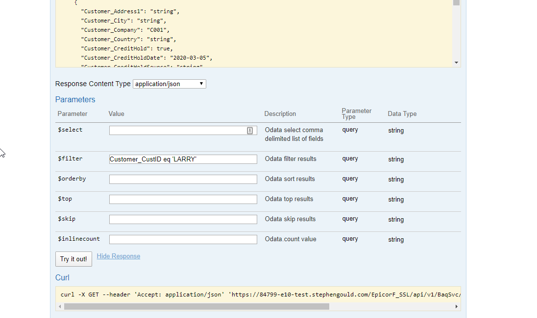

this is for calling the whole BO service but when using BAQ the filter code is a bit different
https://EpicorDomain/EpicorEnvironment/api/v1/BaqSvc/BaqID(Company)/?$filter=TableName_FieldName eq 'Value'
