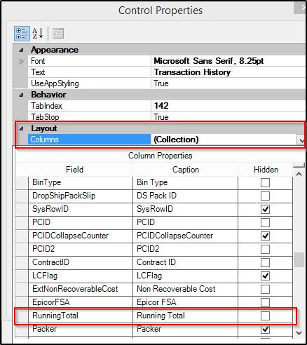

Take a look at
When in Part Tran click on Tools, Personalization
Then click in the grid layout area
In the Control properties box Click on Collection, Check the “Hidden” Column and make sure Running Total is unchecked.
