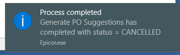

Running PO Suggestions results in "CANCELLED"
When running PO Suggestions, the process task immediately ends with status = CANCELLED
Any idea why or where to look?

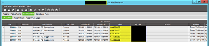

More info:
The SysMonitor history shows:
The History -> Report Detail and History -> Report/Task Logs tabs show no information.
Other reports and processes complete normally.

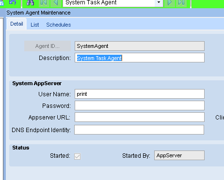

So IDK if this issue is unique to us but it looks like our issues was:
ā€œthe scheduled tasks are somehow using the old ā€˜print’ user for these tasks. But that print pw gets wiped out in the SysAgent record, so I found a query to put that pw back in the table, restarted the task service & it now seems to be working fine.ā€
I do wonder if there is a best practice around ā€œsystem usersā€ like manager and print?
Why using a query instead of going to System Agent entry?

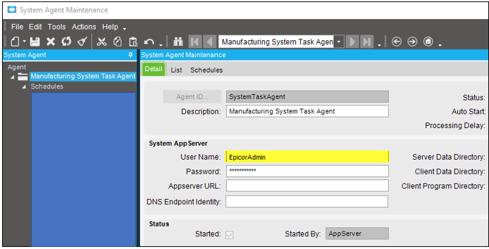

I wanted to add to this post with what fixed my PO Suggestions resulting in ā€œCANCELLEDā€ because it wasn’t instantly obvious to me what needed to be done to fix it.
I installed the latest ERP10 version in a Test Environment and brought in a copy of our Live Database. When I first logged in as my EpicorAdmin user it instantly forced me to change the password and of course I couldn’t re-use the same password. (Don’t Judge. :stuck_out_tongue:) I’m not sure why it forced me to do this right away when I first logged in but I had to change the password when I initially logged into this new environment.
Since I had slept since then, I kind of forgot about changing the password for this account. I then decided to try to test the Generate PO Suggestions and MRP processes and for some reason they kept instantly going to a ā€œCANCELLEDā€ state in my System Monitor.
I kept looking at my AppServer Task Agent Configuration (deleting, uninstalling, re-installing) and System Monitor Tables (clearing out unneeded records) but nothing I did fixed it. I eventually realized that it was my System Agent Maintenance record that had the wrong Password for my EpicorAdmin user in the System AppServer settings. I forget about this record because usually you set it and then never have to look at it again.
I’m actually surprised that the SystemTaskAgent is still using an Epicor User and Password verses Windows Authentication. It would be nice if this could be changed to use Windows Authentication and that way, when I am forced to change the password on my Epicor Admin User it won’t affect my SystemTaskAgent. Just an FYI on what fixed this issue for me. :slight_smile:
We have specific E10 account just for the System Agent (as recommended by the E10 installation instructions).
And didn’t set the password in Sys Agent Maint:

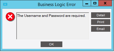

Well that is strange. If I leave either/or User Name and Password blank in the System Agent Record it says that they are required. And updating the password in that location is what fixed my problem when everything else I tried failed to… :woman_shrugging:
