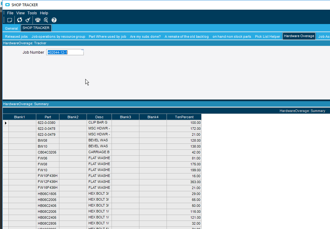

So I have a BAQ/dashboard in a runtime dashboard, that all of the sudden doesn’t work. The BAQ works fine in the designer with a criteria set on the table, but in a dashboard, it just returns nothing. We’ve been using it for at least a year with no issues until now. Any idea what could be causing the problem?
In pilot it works just fine. This a job we did last year.
In production, nothing.
These are the filters that I have on the grid.
The options for the tracker.
here’s the query phrase

it’s really weird. I got it to work for the old job by adding the company in the display fields, but when I tried the new job that is giving us problems, it breaks it for that job and every other one that I try.
Here’s the new job in the designer.
I don’t know what’s going on here…
Never mind, nothing is over 15 :man_facepalming: The job seemed like it was big enough that it should have worked.
I don’t know what I did to think that it was broken for other jobs. Trying to go too fast I guess.

And something weird was going on. I still don’t why the old job wasn’t working there for a while. I have the screen shot to prove it. But it works now. :man_shrugging:
