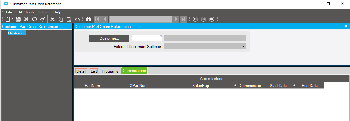

We configure the Commission via a UD05 Table, it is connected to the Customer XPartNum (Cross-Reference) UI for managing it.
Then there are 2 BPMs that ultimately calculate, the payout.
