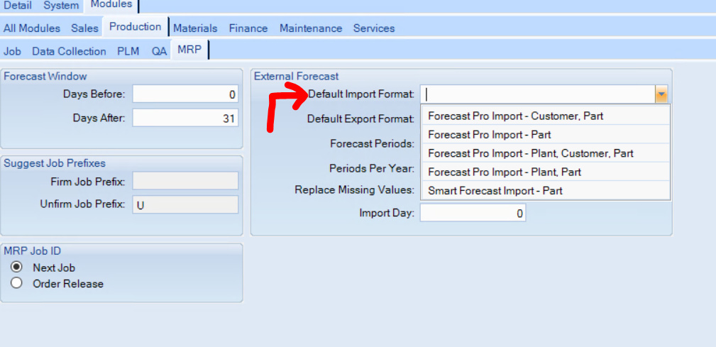

Just testing out the forecast behind MRP,
  1. Do you know where we get the software for “forecast pro” or “smart forecast import”?
  2. After MRP has been ran what areas exactly are updated?..at first glance it appeared Time Phase updated and if i generate suggestions then go into New PO suggestions it seemed to put quantities into there too.
Thanks.

Check with your Epicor CAM for Forecast Pro. I’m not sure if it’s an Epicor product or just one they integrate with.
When you enter a forecast and run MRP, you’d get the same result as if you’d entered a sales order for that part in that quantity with that ship date… so if it were a manufactured part with a BOM, you’d get a Job suggestion to build it and purchase suggestions to buy the materials (unless they were already in stock).
