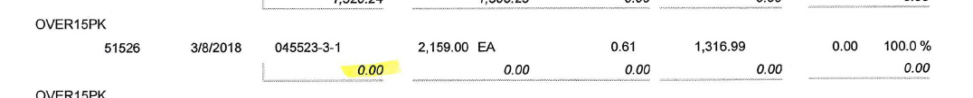

We have some questions on the Sales Gross Margins report. What causes it to not pull labor information over to the report? For example yesterday when run there were 8 invoices listed where the labor data was 0.00 and the margin was listed as 100%. When run today only 6 invoices have this issue.

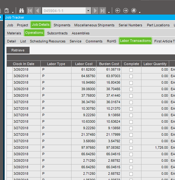

Look at the job this part was built on. Do you see labor transactions in job tracker and do they show costs?
The part is average costed and there are labor transactions and they have costs associated.

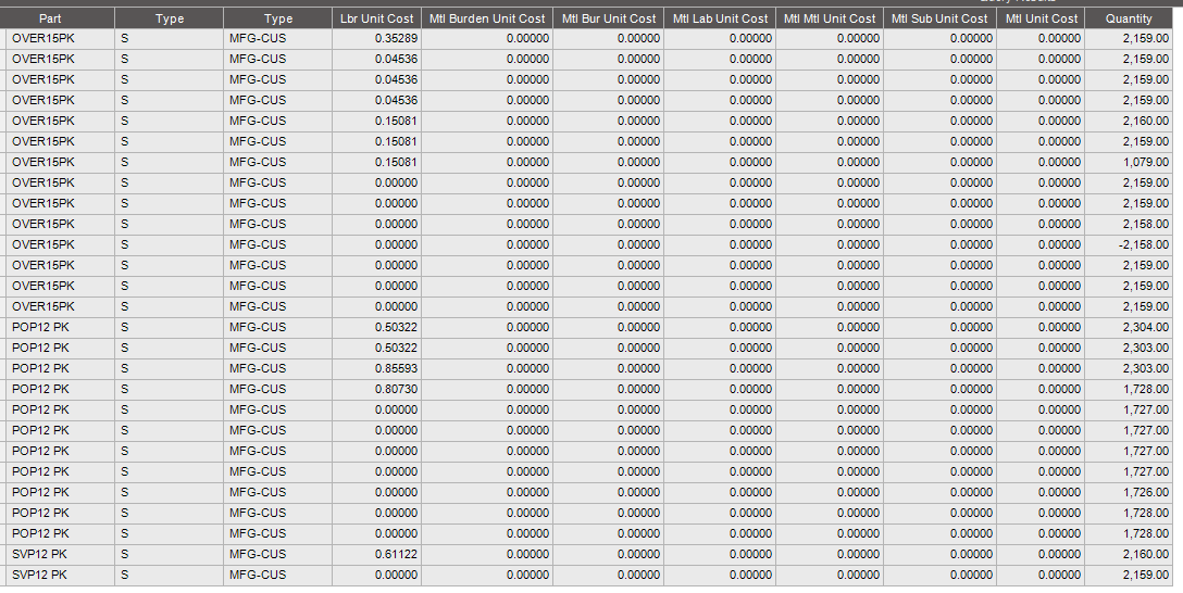

Here is an example of one that changed since yesterday. I did a BAQ based on the AR Invoice table to see what it looked like over there and there is no labor unit cost data coming through for any of the ones that are showing as zeroes.

PartTran also does not have any detail for these records.

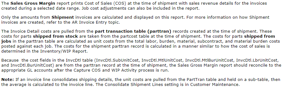

EpicWeb states

The PartTran record itself isn’t showing any Labor Unit Cost so it makes sense that it’s not populating to the report. What would make PartTrain not have the cost?
