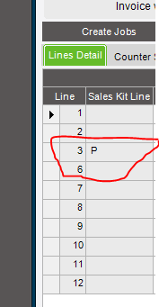

Does anyone know if it is possible to display the kit components on the Order Entry Summary tab? Notice it only shows the Parent (P), but not the Children (C). It hides order lines 4 and 5 in the Summary.

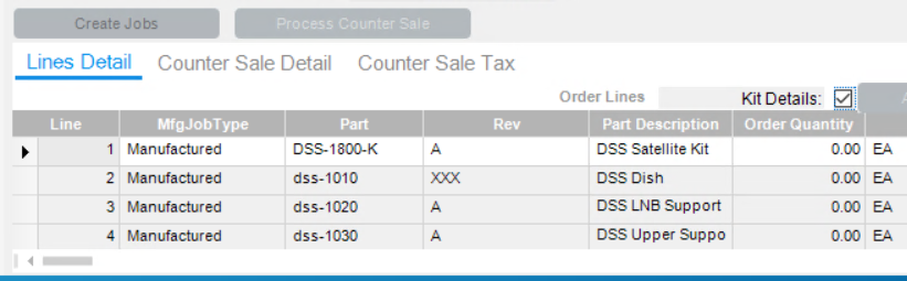

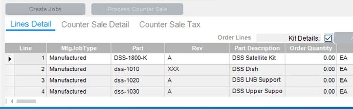

Run your mouse right from the green Line details and there is a white Kit Details box tick it and the components will show

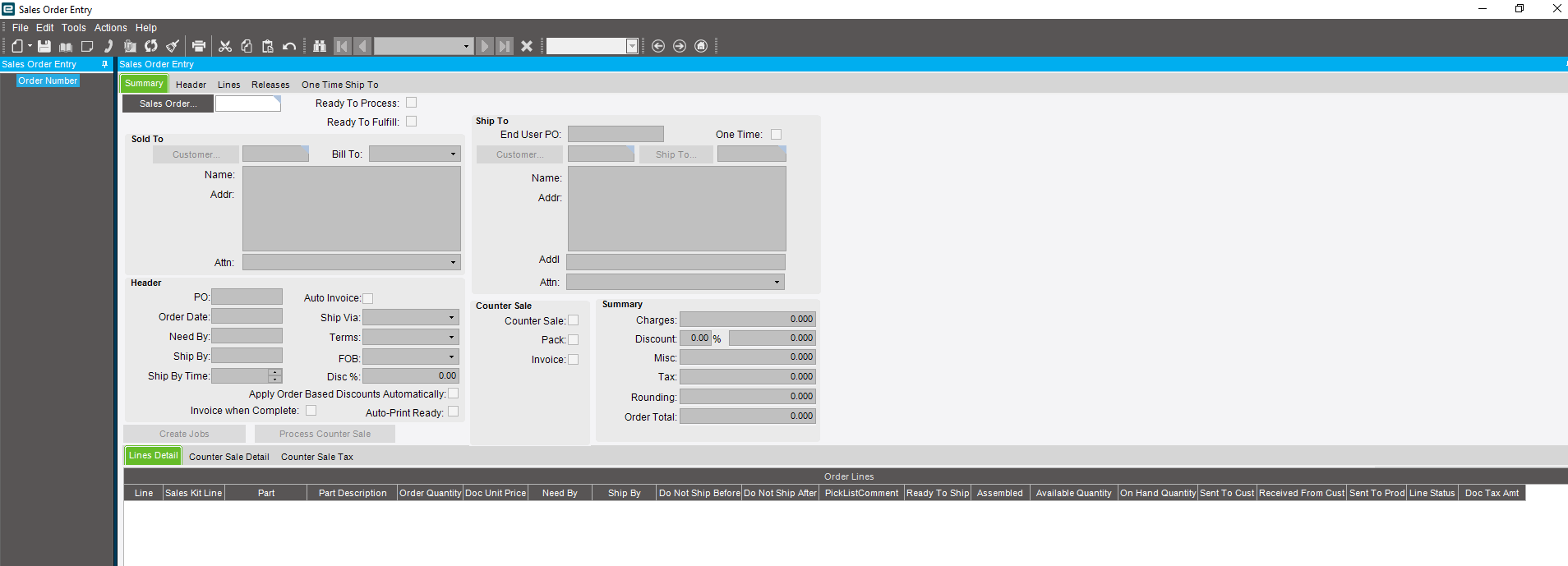

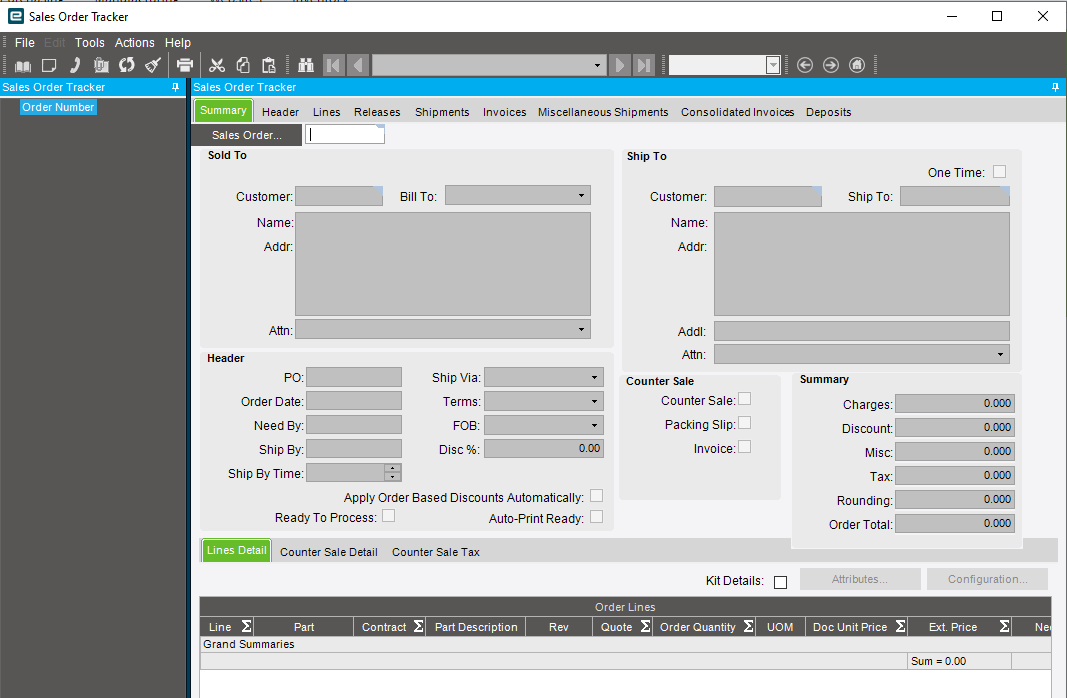

We see it in Order Tracker, but not in Order Entry…
Check to see if you have a screen customization on your Order Entry screen… run it in Base mode and see if it shows up that way.
That was it. Thanks!
