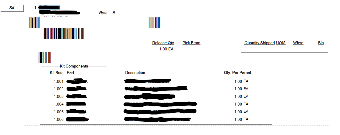

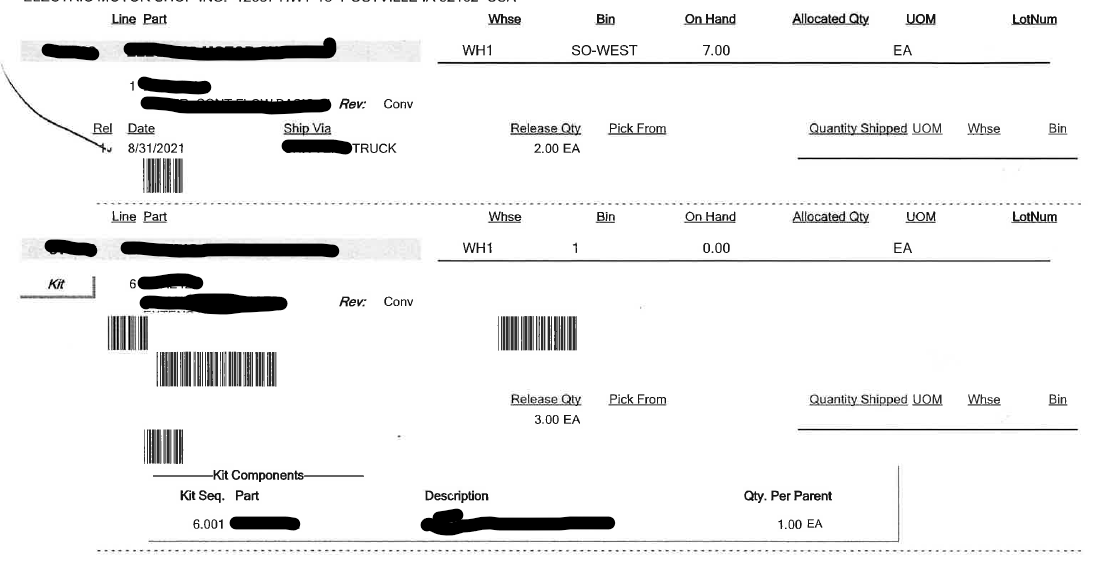

Can you show a screenshot with a non-kit line and a kit line? Mostly to show where the ShipVia is appearing on the non-kit line.
Sure!
I looked into the RDL and see that the field for the ShipVia has the expression:
=iif(Fields!KitShipComplete.Value, nothing, Fields!ShipViaCode.Value)
So unless the KitShipComplete is set on the order, it won’t show on the SOPickList
