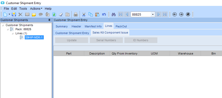

  2. When I go to make a packing slip for the sales kit to pull the components of the kit, the “Sales Kit Component Issue” screen opens, but no components of the sales kit get loaded. So I cannot complete the pack slip.

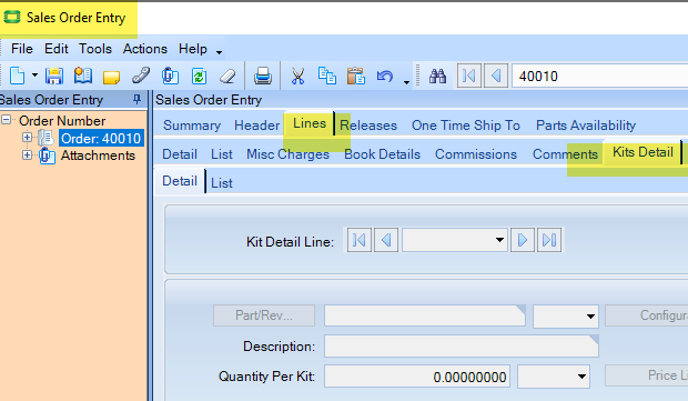

Ensure Print Kit Components is checked on Sales Order Pick List print, per screenshot 1. Ensure that the Sales Order shows the components loaded via Lines / Kits Details tab below. If they are not their, you did not get them loaded onto the sales order, either because you changed the part to kit after it was on order, or some other processing difficulty. Once in a great while, our bigger kits have problems loading, but we never see partial load, either its all there or not. Changing part number and then back again on SO line usually fixes it.

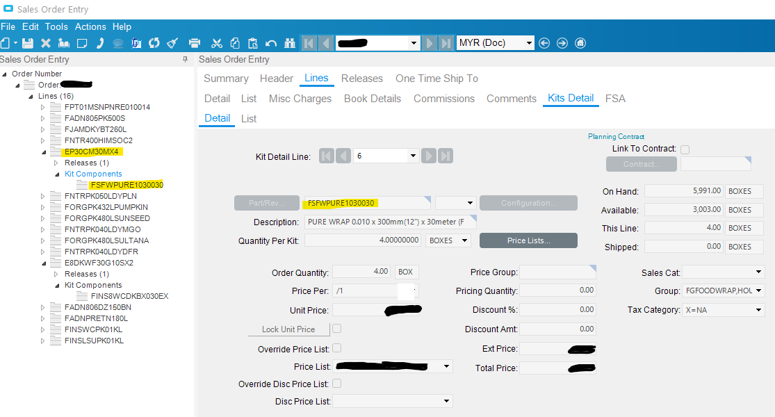

Before ship the sales kit component still there, when i trying to save the records the component will be missing.
I has check the component was setup properly and did exist in sales order as following.
Just feel wired or why it keep missing when save, In BPM method directive I use posted method and does that not unable to update quantity and component? The purpose is to auto fill the lot number for those lot tracked part on either normal line or sales kit in component level.
