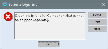

Sales kits are implented as individual line items on the order. Trying to add the lines of the components to a packer yields:
I tried making a BPM, to intercept the check if the line is a kit component, but I can’t seem to figure out where that happens. Only 2 BO’s get called
  • Erp.Proxy.BO.CustShip.CheckPrePartInfo
  • Erp.Proxy.BO.CustShip.GetOrderLineInfo
The detail in the error says it is in BO.CustShip.GetOrderLineInfo, yet a Pre-proc BPM that does nothing but display a message, doesn’t fire.
