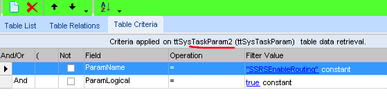

Good Plan I like it, But How do I access the SSRSEnableRouting to determine if it was true?
Can I track a report being printed and the SSRSEnableRouting = true in a BPM process?
If so where?

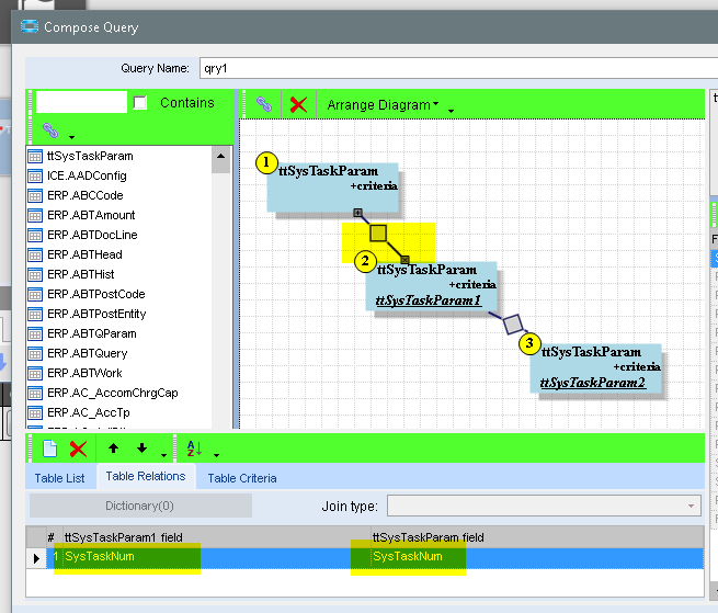

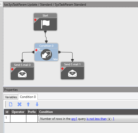

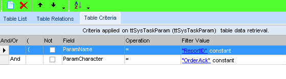

Just insert addition ttSysTaskParm tables. You’ll get a warning that the first dup needs to be re-named ttSysTaskParam1, and then the 2nd will be ttSysTaskParam2.
How do you link to tttables together in Custom Code?
foreach (var ttSysTaskParam_iterator in (from ttSysTaskParam_Row in ttSysTaskParam
where (string.Equals(ttSysTaskParam_Row.RowMod, IceRow.ROWSTATE_ADDED, StringComparison.OrdinalIgnoreCase))
select ttSysTaskParam_Row))
var ttSysTaskParamRow = ttSysTaskParam_iterator;
You don’t really have to link tables in code. That linking in the query was needed because the desired info was in different records within the same ttTable. But there was no way to select them in groups like the query did.

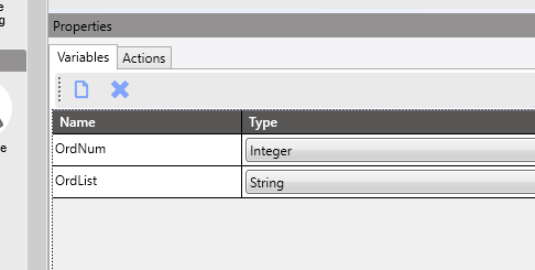

//This code will update the JE_JobNum_c on OrderHed
//this uses a technique called LINQ (Language Integrated Query) to have SQL-like syntax in C#
//Define your tables that we will reference below
//Ice/Erp tables can look like this
//the first part is the type, the second is the variable name
Erp.Tables.OrderHed OrderHed;
//now we are going to look for the OrderHed record that matches this variable OrdNum. Make sure to also search by company, like any SQL query. The Session object is good for this.
//this will select, in this case, a single ShipHead record from the database
OrderHed = (from OrderHed_row in Db.OrderHed
where OrderHed_row.Company == Session.CompanyID && OrderHed_row.OrderNum == OrdNum
select OrderHed_row).FirstOrDefault();
//if the record is not null, we will continue
if(OrderHed !=null)
//now we will set the field on the OrderHed record
OrderHed.JE_JobNum_c = "PRNTD";
