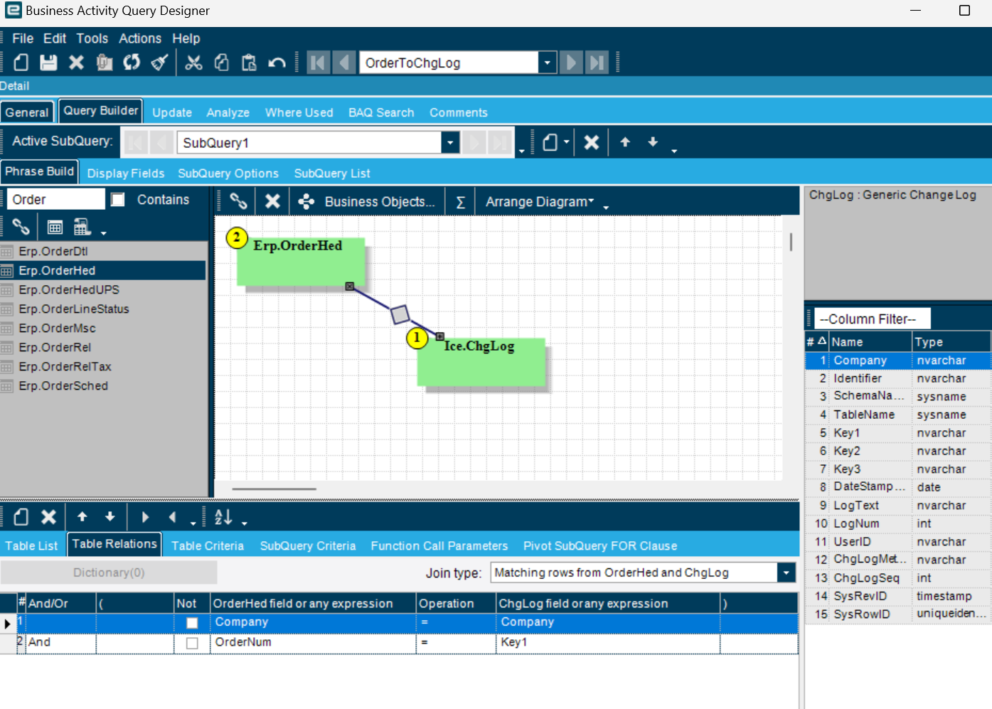

You can get Order Created date via the Change Log (if it is turned on). A little convoluted, but at least the date/time is on record.

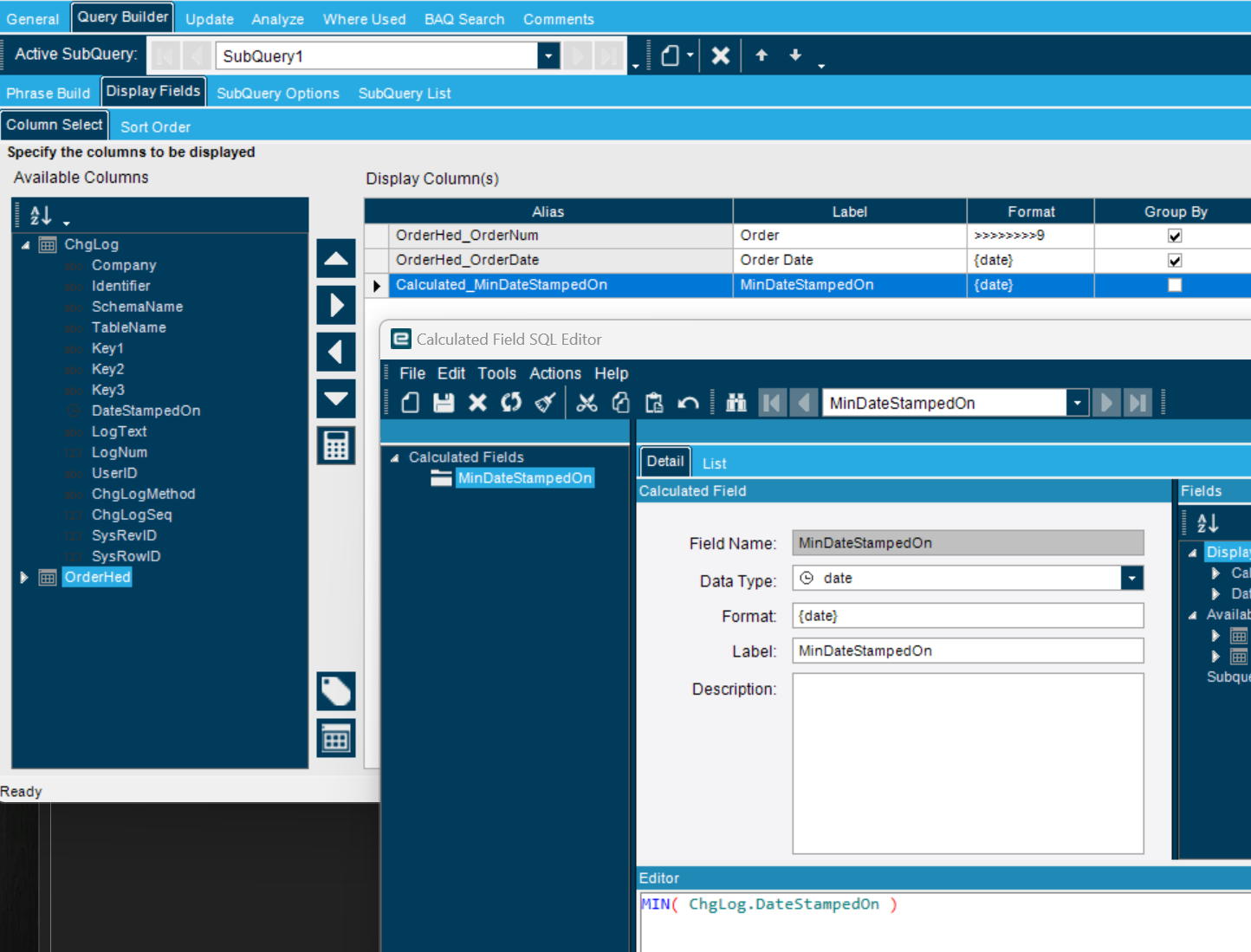

Yeah if the Change Log is on then you should be able to grab the create date from the oldest ChgLog record. Something like the below BAQ should do the trick.
