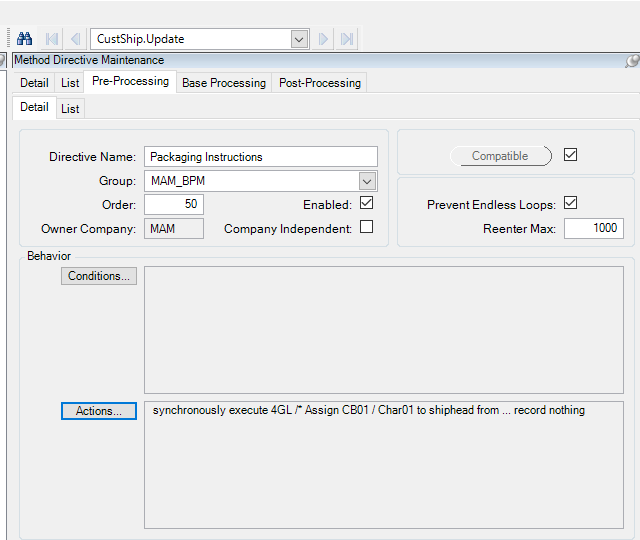

I’m just getting back to this customization. I don’t have CustShip.UpdateMaster as an option, could it be because I’m using v8.03.810? So I used the CustShip.GetManifestInfo and pre-process. I changed the ttShipHead.OrderNum to ttShipDtl.OrderNum. The information transferred to Customer Shipment Entry like I wanted. A couple of problems, I don’t get the message we coded in and when I try to save the transaction I get the error message; “Record has been modified by another user…refresh button and re-enter you changes.”. So when I refresh it removes the line item and I have to re-enter it and then I get the error message again. Any Ideas.

I’m not sure what to try. I tried CustShip.Update again and no information was passed. I’m not sure where to look for the trace file. Thought that came out in Epicor 9 also or are the server log files the same?
