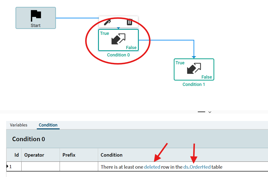

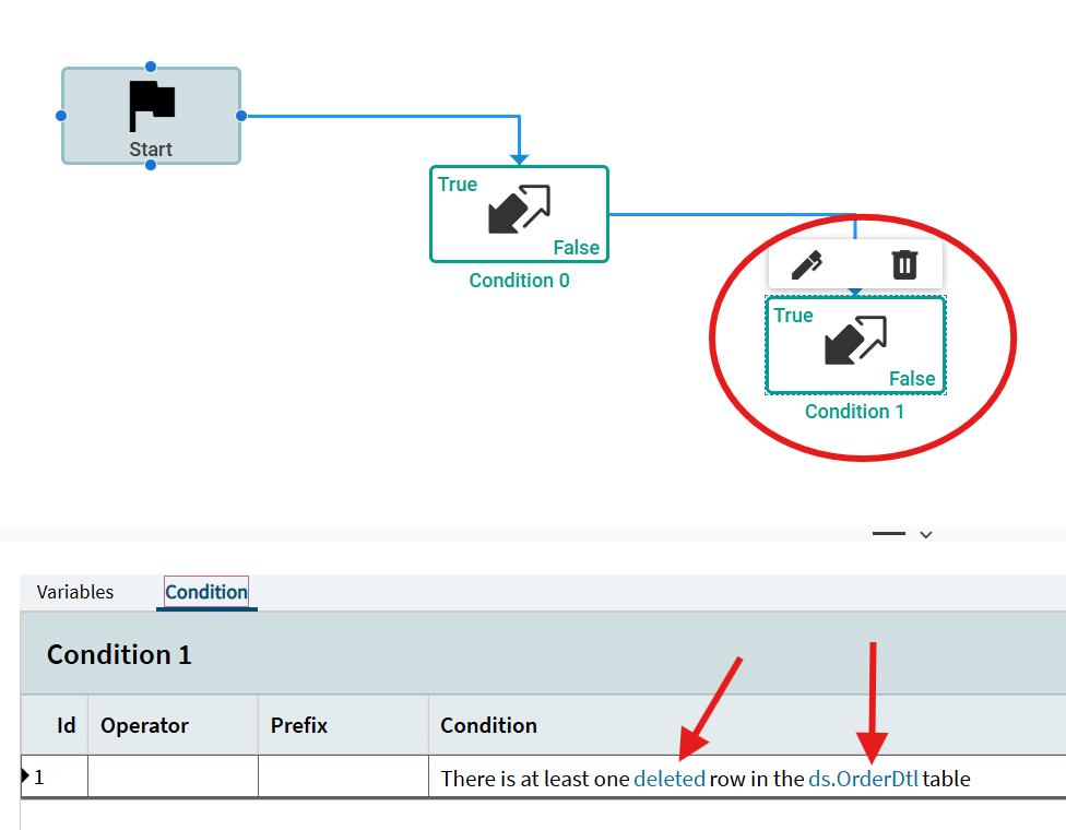

You could put a pre-processing BPM on SalesOrder.MasterUpdate and check for deleted rows on OrderHed vs OrderDtl.
Then throw a BPM Data Form if either is true to confirm if they want to proceed.
EDIT: Use SalesOrder.Update, not SalesOrder.MasterUpdate

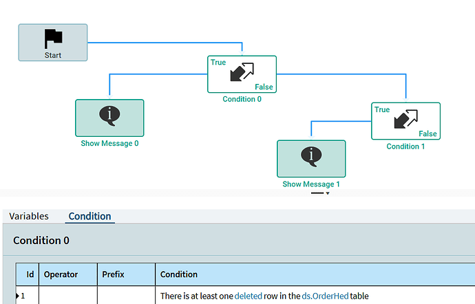

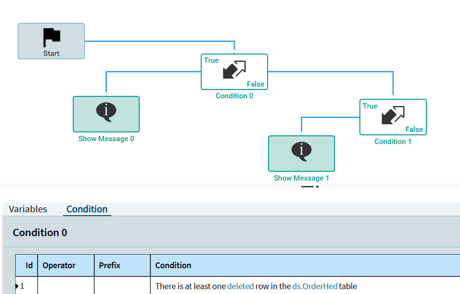

Hi Kevin
Thanks for the response. Unfortunately, this doesn’t seem to work. I have created a simple BPM that shows a message, but nothing is appearing.
Am I missing something?
kve
(Kevin Veldman)
September 29, 2025, 5:56pm
4
I just did a test and it looks like I gave you bad advice. The BPM is the same, but it needs to be on SalesOrder.Update, not SalesOrder.MasterUpdate
