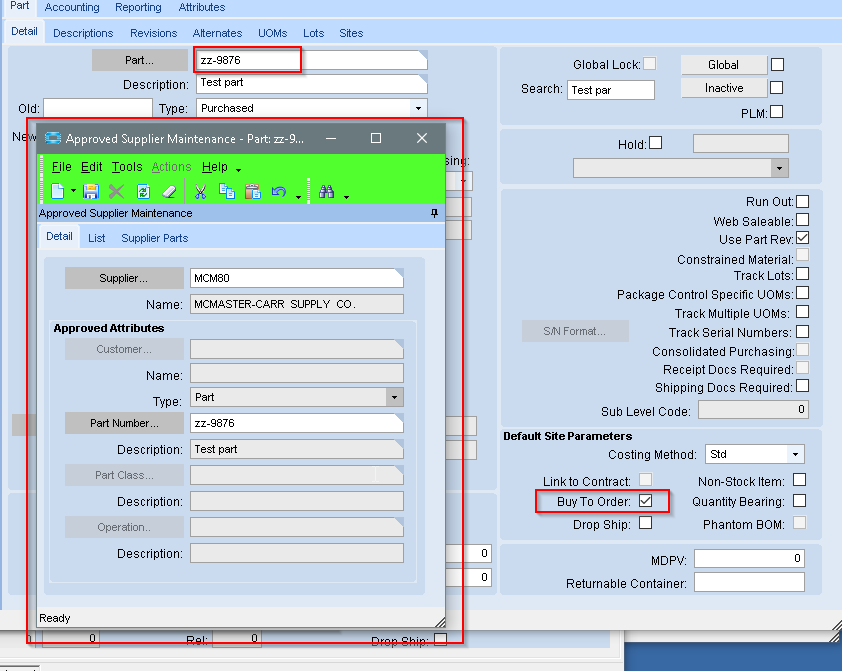

Hi Calvin,
I thought dohp (homer simpson) and then checked. It does indeed populate without running suggestions, nor mrp. I do have generate PO suggs checked on the part / site but I didn’t run it and get this:
Nancy
All you did was enter the part (after setting it up as BTO, and adding an approved vendor and vend Partnum) on the SO Line?
When I do that the part does create the release as BTO, but the supplier fields (ID and name) remain unchanged.
I even tried with the Part as Qty-Bearing and not Qty-Bearing
Yep, I just entered the part on the sales order line and got the vendor info. One difference on mine, I have vendor in the Part / Site field per below:
Adding it to the Part\Site\Detail is the key.
Turns out you don’t need to add the vendor as an approved vendor for the part. Just need the Part to be BTO, and set the supplier on the site.
Works, regardless of the Qty Bearing field. Although that will affect the PartTran Type
BTO && QtyBearing := PUR-STK
while
BTO && NOT QtyBearing := PUR-UKN
