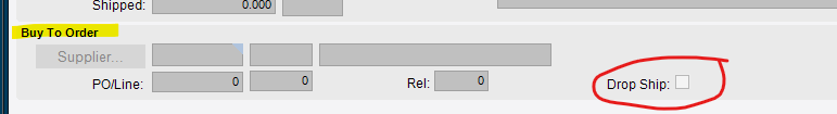

When we do drop shipments, the Drop Ship checkbox must be checked on the Sales Order release tab:

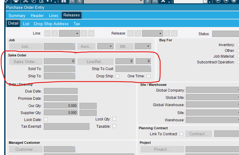

Then when the PO is cut, your buyer needs to put in the Sales Order number, Line and Release:
This is what links the PO to the Sales Order. When the item is received, the receipt entry is done under Drop Shipment Entry, not Receipt Entry. If the receiving person tries to do it under Receipt entry, it will display a message. Once that is done, the system will automatically create a “shipment” to the customer behind the scenes so that it appears in Invoice Entry when you Get Shipments.
